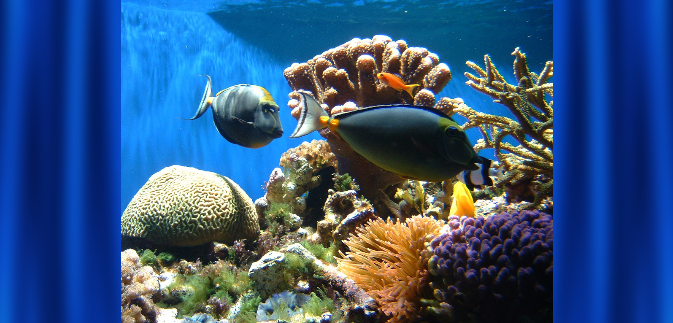

I have taken a look at a variety of things and started thinking a vintage look. Maybe a curtain that changes in a subtle way along with the colors of the video or maybe it does not change at all. Maybe food for thought... I have not been to a movie theater in years but I do remember they had curtains :)

@Don, adding those "side curtains" could open up a huge amount of possibilities, it could be another place for a folder for advertising me thinks.

I was thinking the same thing tayla. Just black is not very appealing and might as well use the space for something. Could be simple like color and your logo or more elaborate. Main thing is not to detract from the video to much. Curtains or any image could open and close revealing things. It makes a difference if you are just viewing videos or you have an audience like you guys do on what you might want to do with this.
