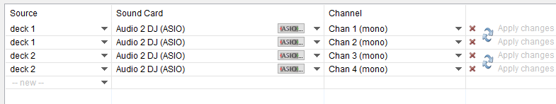

Or you could try this way..
Assuming you're using audio from your controller, or it could also work with the onboard 5.1 sound card..
In my example, you need to duplicate each deck to route the same to both left and right this gives mono.
save as a preset in the bottom right of the audio config screen.
