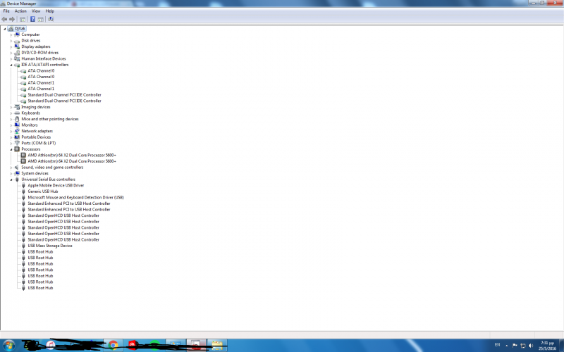

@ DJ PHATSO
WINDOWS 7 UTLIMATE ,SERVICE PACK 1
Processor: AMD Athlon(tm) 64x2 dual core processor 5600+ 2.80 Hz
Installed memory (ram): 4.00gb (3,75 gb usable)
system type : 64-bit operating system
Posted Wed 25 May 16 @ 4:26 pm
It is quite difficult to see from your image, but you don't seem to have any USB 3.0 controller on this computer.
Do you have the computer or motherboard manufacturer and model number so I can check the specifications ?
Posted Thu 26 May 16 @ 4:08 pm

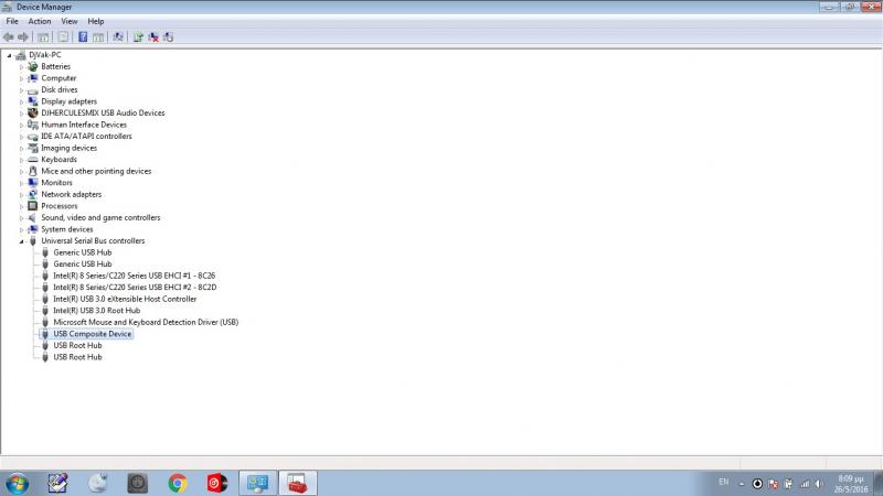

Sorry by mistake i wrote my pc specs.
These are the LENOVO laptop specs:
WINDOWS 7 ULTIMATE ,SERVICE PACK 1
pROCESSOR: intel(r)Core(TM) I3-4000m cpu @ 2.40ghz 2.40 ghz
Installed memory (ram): 8.00gb
System type : 64-bit OS
There are 2 USB 3.0 ports on the left and one USB 2.0 on the right
LENOVO IDEAPAD G510 59-401354 15.6'' INTEL CORE I3-4000M 4GB(+4GB ADDING BY ME) 1TB AMD RADEON HD8570 2GB FREE DOS.aLSO I ADD AN SSD 120GB HARD DISC FOR OPERATING SYSTEM AND I USE THE 1T HARD DISK FOR MY MUSIC AS SECOND HARD DISC AT THE PLACE OF THE CD/DVD PLAYER/WRITTER
Posted Thu 26 May 16 @ 5:01 pm

djnet71:
Thanks for the new system specs. This makes much more sense :-)
I can tell you that you controller should normally work on Intel's USB controllers (one of the most wide spread type out there). We have several configurations here using the same chipset and they were obviously verified using the latest drivers before they were released, with multiple versions of Windows.
That being said, every computer is different, so a conflict with something else installed on your computer is not impossible. You didn't happen to not the error message given by the Blue screen ?
Posted Fri 27 May 16 @ 2:12 pm

@ DJ Phatso
i couldn't make it so i upload it here : http://s33.postimg.org/8ua4me3v3/virtual.png
Posted Sat 28 May 16 @ 6:36 pm
