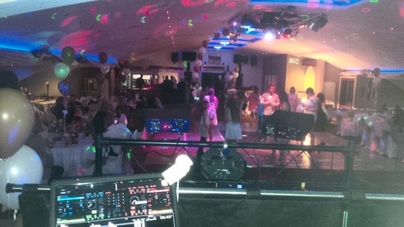

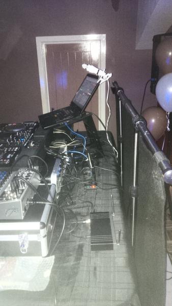

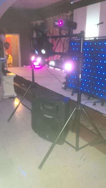

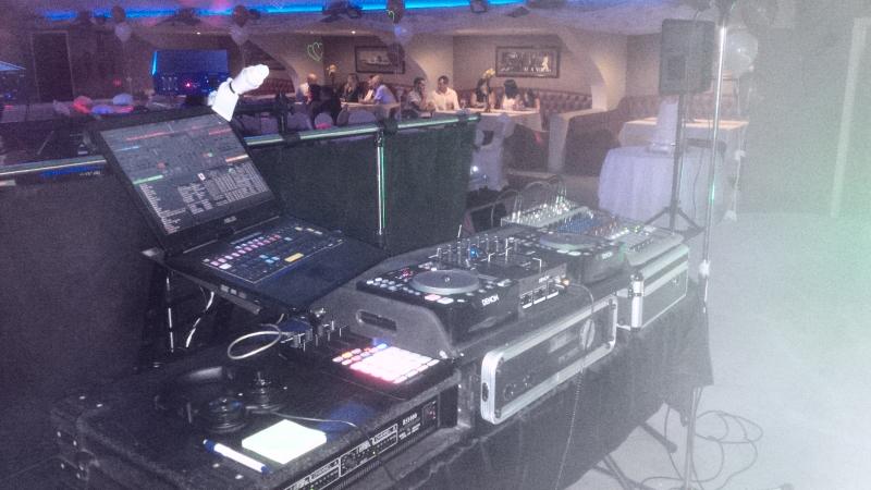

A photo of my mixer sorting out my line level problems, and microphone control.
..and a few more.
Tayla suggested the star cloth to cover my wiring and it has worked very well !
It was cheap, and effective.
PS: The frame supporting the star cloth is just an Ebay £12 clothes rail !
