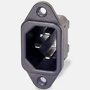

If you have the skill, for ease of use I'd add another IEC socket (female) to the can, so you can daisy chain different lengths of cable between units (male in, female out). That's assuming you have already have an IEC socket on the can and is not a length of flex coming out with a plug on the end.

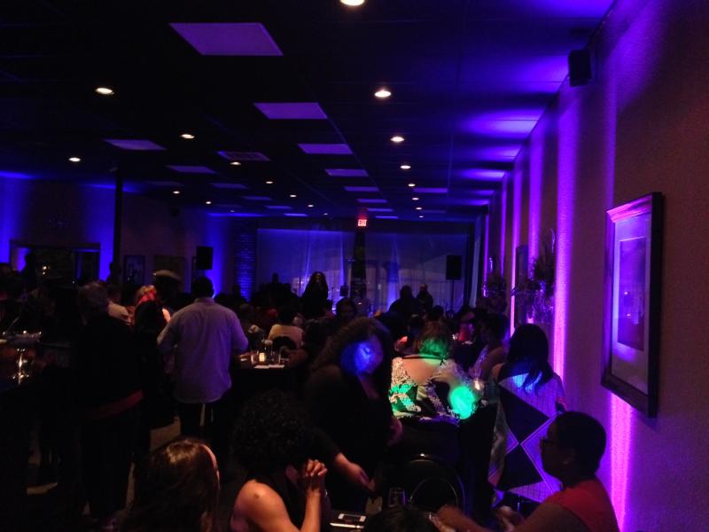

They're about 4 to 5 feet from each other. And they're just no name Ebay flat par lights from China. I know, I know...that's bad, but I got all 14 of them in a complete package for only $120, and they're 18 watts with 6 channel DMX, that are extremely bright and have worked flawlessly the 12+ times I've used them last year. So I cant complain at all about them.
They don't have power outlets to daisy chain so that's out for me, and I wouldnt want to try and cut them open to put new outlets in (not quite that skilled). I guess I'll just get a couple of those multi-outlet extension cords I posted in the original post and that should be 100% fine for my needs.
