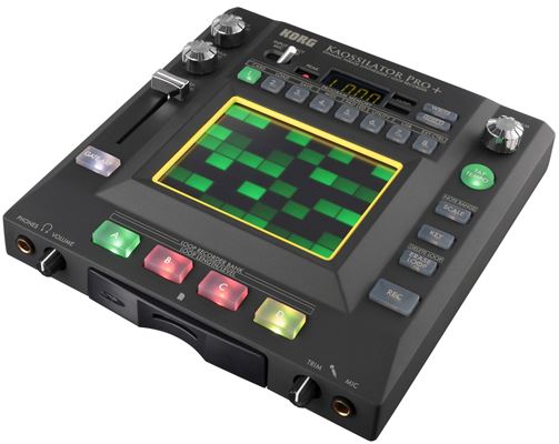

I need the BPM to change to the closest integer, because I am using an external machine (Korg Kaossilator) to add rhythms. And it's easiet to sync the things if BPM is spot on integer.

No, this one:
