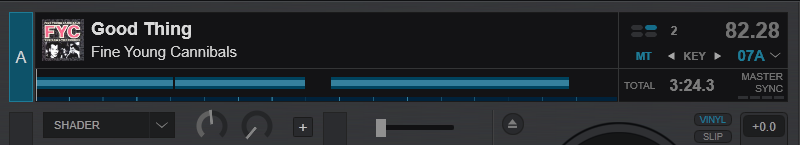

Hopefully the plugged leak will stop this from happening too:
The deck waveforms (set to 'shapes') were drawing as the file loaded then flattening out or not showing. I had to switch back to 'beats' waves.
