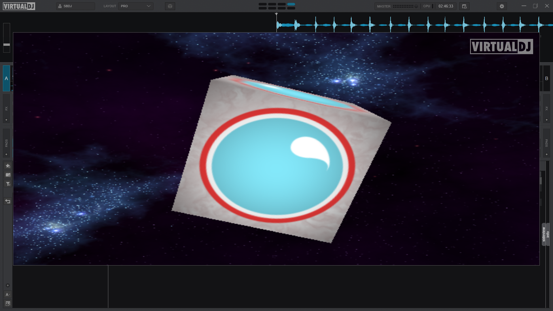

DX9 off seems to have solved the Resolume crashing, but still have major issues with the Spout image size in VDJ.
It seems totally random whether I get a full size image, a small one or nothing at all.
[later] The VDJ video output window seems to be an issue. If I enable the Spout input with just the preview window active on the skin, I get a full screen Spout feed.
Enable the video output window and the Spout feed in both the preview and output windows shrinks.
Changing the size/shape of the output window really messes with the image in both windows.

I think I see where the mistake is with the spout plugin. (although I don't see the spout64 receiver source on github)
It tries to update the plugin input texture, and then have VirtualDJ render it to the output.
The input texture size will depend on the previous plugin, or the video loaded to the deck though, so this is indeed not guaranteed to be in any resolution.
It also seems to ignore the width/height of the plugin, and use the input image texture instead.
What VDJFLAG_VIDEO_OUTPUTRESOLUTION does is make sure the output of the plugin is the same resolution as the video window/screen/recording.
In order to properly use this, the plugin should create its own texture from its source (and if it has control over the spout sender prefer that the sender sends in the resolution as set by the plugin width/height properties), and then draw that texture itself to the output and return S_OK, instead of having VirtualDJ draw the original input texture.

It is indeed a little bit involved from scratch in DX11 since you can't really access the shaders VDJ already has available.
So basically
-Set shader, blendstate, texture to use and sampler
devContext->PSSetShader
devContext->OMSetBlendState
devContext->PSSetShaderResources
devContext->PSSetSamplers
-Create and update vertex buffer (can be cached between frames if the same)
d3dDev->CreateBuffer
devContext->Map
devContext->Unmap
-Select vertex buffer
devContext->IASetVertexBuffers
-draw
devContext->IASetPrimitiveTopology
devContext->Draw

Thanks Adion,
For the old DirectX 9 plugin we could stretch the received texture to the VirtualDJ one, then we needed to know the size the texture. But that's not possible here so I have done the best I can. There is potential for high speed transfer to other programs and I would like to solve it for people to use. But, like Nicotux, I have not been able to work out what to do with it.
Unfortunately this is where I have to leave the project because it has become too complicated.
All the source is open if anybody wants to have a go at it. Go to here (https://github.com/leadedge/SpoutVDJ) for the master branch that has the sender, where you see "Master", drop that down and switch to the beta branch for the receiver. The receiving part is reliable, so it's only the drawing part that needs attention.
The sender is solid from all reports.

Fixed :)
Posted Wed 06 Jan 21 @ 2:45 am
I'll put a pull request back into the repo and you can look at my changes. I made some other changes too - I thought it was better to cache instead of constantly create - it also looked to me like it was leaking too.
Feel free to take what you want from my changes. The only thing I won't push back is the project file because it had to be upgraded to work with my VS. Only project changes are:

Hey Scott.
many thanks from everybody I am sure. It was too much for me and your experience shows through. I certainly won't make it mine because it's always been for everyone using VirtualDJ, but I will add to the receiving part as that is improved.
I will create a new release as soon as I can so that people can use it.
Edit : it looks like we need "PixelShader.h" or have I missed something.
Edit again: I think I have figured it out.
Edit again again : Release uploaded(https://github.com/leadedge/SpoutVDJ/releases/tag/v2005 )
I hope I got it right. It works OK from what I can tell. Any problems we just keep going till it does.
