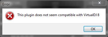

Anyone getting this error when trying to run the Spout plugins (sender or receiver)?
EDIT - Scratch this issue. I had downloaded the DLLs from the Spout site and those gave me this error. I took copies from the Spout install folder on my PC and those worked.
