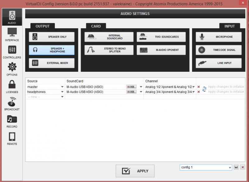

sweet i downloaded the 64 bit version of win 7 and its working on my win 8. thanks guys
one weird thing though when i first started playing songs had the headphones plugged in and went to cue the next song, at first only the song i was cueing was playing and then like halfway through the song both started playing in my headset. any ideas? picture below shows the change after the download
again I appreciate all your help
Posted Fri 13 Feb 15 @ 10:11 am
I see you've now got a dedicated Xponent setup button in the centre there - so even if you didn't know how to set it up, pressing that button would do it for you.
