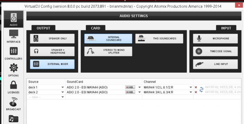

Audio settings
If you're sending each deck out to its own separate output (i.e. you're using an external mixer) then your "record source" is the output of that external mixer - because that's where the mixing is taking place. To record it using VDJ you'd need to send the mixer output signal back in to the computer, then select that input as a record source.
Alternatively, just record from the mixer using hardware, such as a solid state digital audio recorder (the modern answer to the tape deck).
Or.......you could mix using the internal (on screen) mixer, then the recording could be done "in the box".
You have your output configured to connect it to an external mixer - this means VDJ does not mix up your tracks any longer because you did it outside with a analogue mixer.
You need to connect 1 line output of your Soundcard to a free Line input on your Computer and select this channel to record.
Greets, Heiko

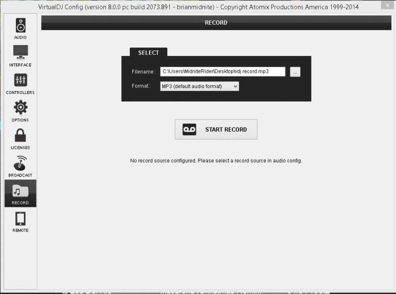

there are 4 deck sources, and i have tried to add a "record" source of which it's soundcard is the Pioneer off channel 1&2, i apply and go to the record tab to be faced with the message "no file selected" when i clich "start record" it is set to be "mp3(default audio format)"
