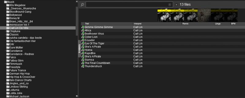

Post a picture of your song browser, it might help us help you.

Is this the screenshot you think about?

That's what I was looking for, but it doesn't answer why you have the problem, it just eliminates a couple of possible causes, I'm stumped
