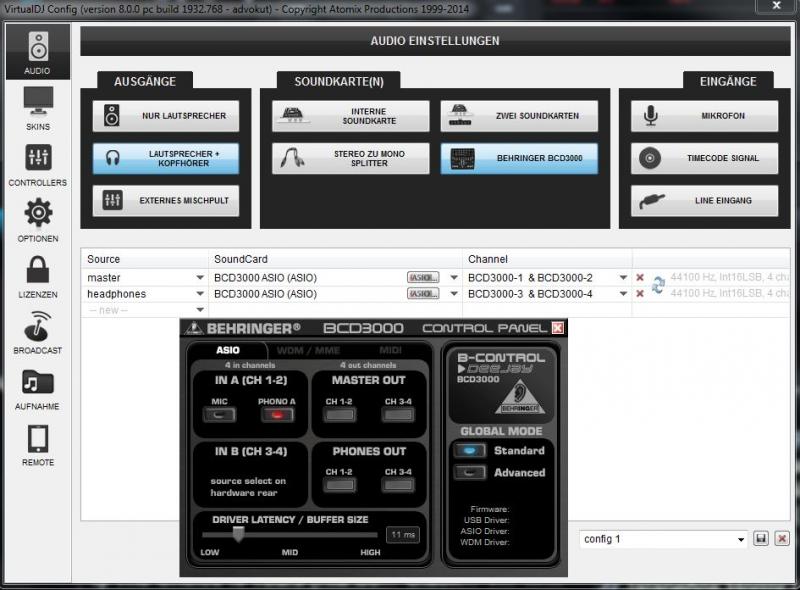

here“s my config ^^
which version of the bcd3kcpan do you use btw?
Posted Fri 29 Aug 14 @ 2:43 pm
thats the one i have but where i find out the version you ask? also i use external mixer since bcd 3 has his own soundcard

In VDJ8, where you see the Audio settings, there should be an ASIO icon to the right of your BCD3000 description. Clicking that should bring up your control panel.
I do not have the BCD3000, but my 3 other ASIO devices work this way.
