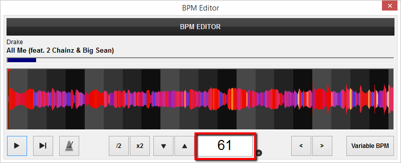

boobash518 wrote :
Has anyone else had issues with bpm readings being all over the place? Ex. Drake's All Me has a bpm of 61 (122) but when I analyze it VDJ8 comes up with 163. Any thoughts or help would be greatly appreciated.
Ok - i tested this and got the same result as you. However because i knew (you told me it was 61) i open the BPM editor and typed 61 into the BPM box and everything was updated.
Granted if you have a lot of songs with this issue this is not a easy fix but for the one or two it works well.

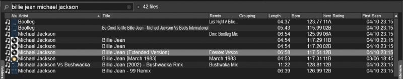

RetrodiscoUK wrote :
Billie Jean is not 78bpm, VDJ7 get's it right.
I also tested this one, i have a few remixes of Billie Jean as most people do but as you can see the original edits all came back around 117bpm, which i beleive to be correct.
Not sure why your have come back so low.

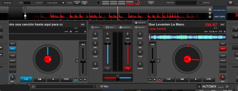

bpm engine, not block songs recorded live, which you see in the picture, takes 148 bpm, and the engine reads it to 194.67 bpm ...
.jpg)
