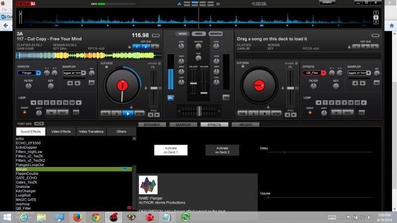

My goal is to remap to a flanger with the Delay slider set to where it is in the attached pic while using the jog to adjust the second "volume" slider. What do you suggest? I've never mapped jogs for anything before so I'm afraid of messing this up.
