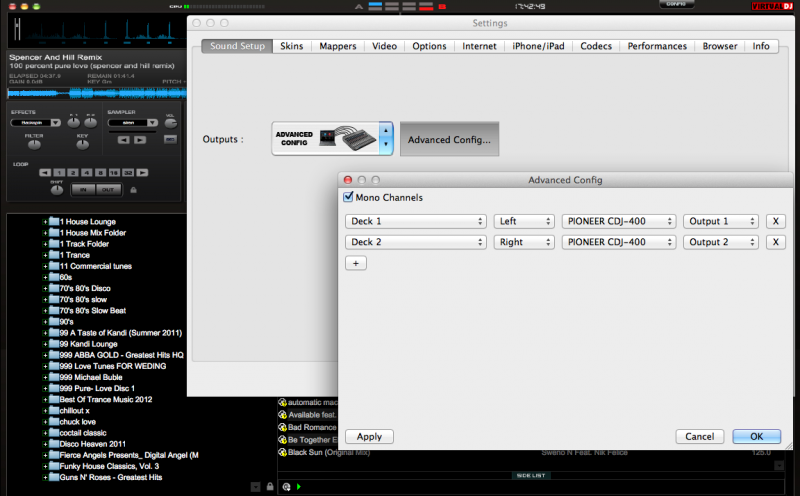

my settings is like yours.
i have used the asio settings but it was a while ago, i think i used that settings with ext sound card.
ok, just realised i was in mac thread, ill hook up my mac.
for some reason i don\'t have asio on mine anymore, strange.
my set up is like this on my MBP w/o sound card

@ pseft : Why do you use mono in your configuration ???
Posted Wed 12 Feb 14 @ 4:59 am
idk… i must of accidentally pressed it without knowing it
Posted Thu 13 Feb 14 @ 7:01 am
sorry for my english...
but... this configuration is not good i think
because you put all decks in mono
where is the stereo ?
you made one cdj in mono and otuer cdj in mono too
the stereo where is ? XD

read my comment above yours...it clearly sez "IDK" which means "i don't know"
