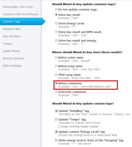

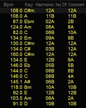

I use this settings in MIK.
This will set the keys in the comment field in vdj, and to see if they (MIK vs. VDJ) really match I use the "Harmonic field" side by side in the browser that use vdjs own search for keys.
Posted Sat 01 Oct 16 @ 8:25 am

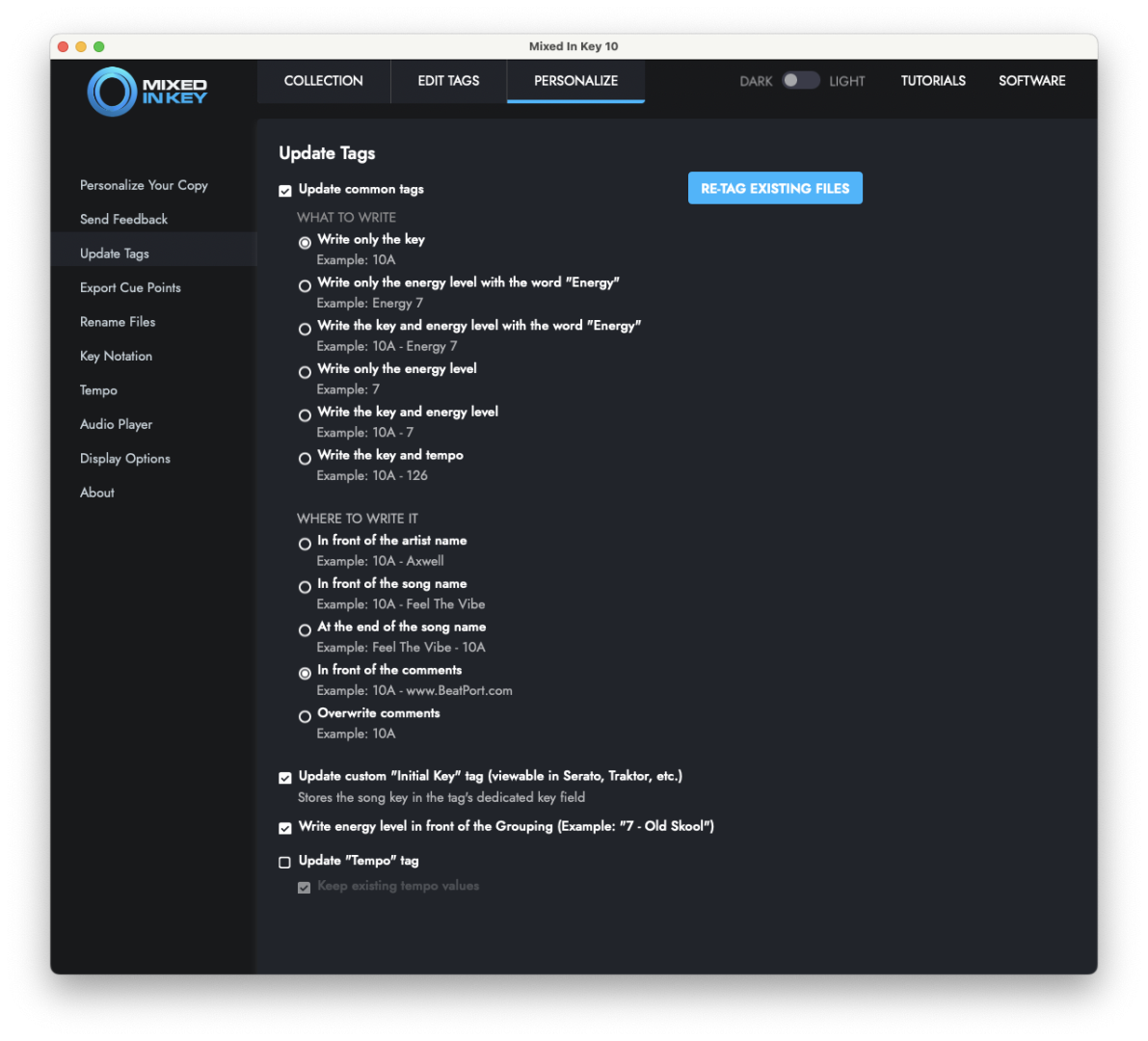

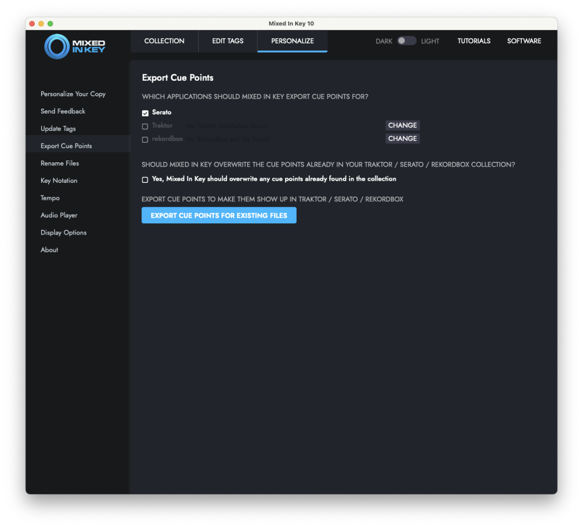

@Manchy76 You do realise you are replying to a post from 2016? Over 7 years ago! 😳 A lot has changed since then. VirtualDJ is on version 2023 Public build b7831 and MiK is now version 10.2.1.4547
I've used MiK since its release in 2006. The trick is getting the settings right. There is no direct VDJ settings, you use the Serato settings for Exporting Cue Points then in VDJ select all files in the browser and right click menu reload tags. Here are my settings that I use every week for Update Tags and Export Cue Points.
If you have the Camelot Column open in VDJ then, checking with the Comments Column open will confirm the updated Camelot Tag.😉
Posted Sun 14 Jan 24 @ 8:46 am
