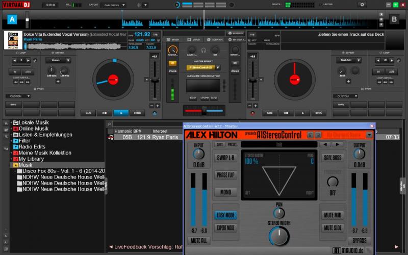

Or you use a VST Plugin Effekt for this Stereo / Mono :
http://www.alexhilton.net/A1AUDIO/index.php/downloads
Greatings,Dirk
Greatings,Dirk
Posted Sun 18 Jun 17 @ 1:18 pm

You can activate the VST Plugin Effects on the VDJ-Decks too.
hope that goes than by a hardware Mixer.
Have not test it so with my AA VMS2 Midicontroller but with
2x External SK with the VDJ 7.4.7 Pro Basic or VDJ 8 Pro Legacy that goes too.
greatings,Dirk
Yes, it works when you use the effect in one of the effect slots on both decks
Just remember to disable "resetFXOnLoad" in the settings
Like this
