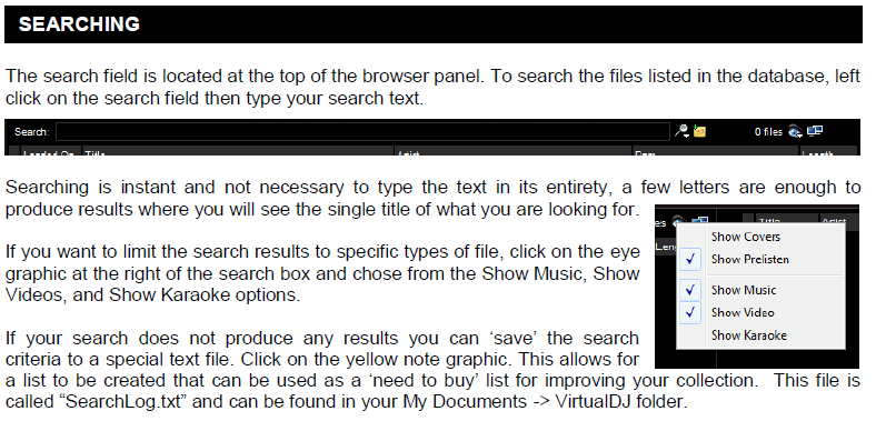

Could anyone suggest a way to prevent Virtual dj from showing karaoke files when doing a dj segment and then not showing the audio only files when doing karaoke? I know they are color coded but I want to limit the chance of error. I have the dj music on the E hard drive and the karaoke music on the F hard drive. Is there a way to make separate databases. Will the F drive show when playing off the E drive?
Can I run 2 copies of Virtual Dj at the same time with each having it's own database?
Posted Sun 13 Apr 14 @ 12:40 pm
view_options 'showkaraoke'
Set the above up as a keyboard shortcut and then it will toggle karaoke on and off in the browser.
If you aren't using VDJ Pro then i'm not sure if you can use custom mappings?
Posted Sun 13 Apr 14 @ 12:43 pm
Page 14:
http://www.virtualdj.com/images/pdf/VirtualDJ%207%20-%20User%20Guide.pdf
VDJ will already create a spereate database for each drive you have connected.
It is named "VirutalDJ local database.xml" and is located in the root path of each drive.
