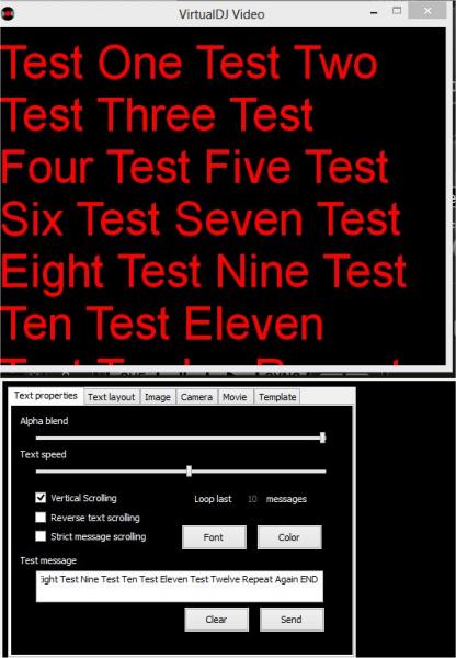

Tried it again this Longer with names, and this is what happened (type all the names before activating)
You should try it so you know.
Posted Wed 15 May 13 @ 8:40 pm
It should scroll like
Test One
Test Two
Test Three
Test Four
and so on.... But as you can see, its no good.
Test One
Test Two
Test Three
Test Four
