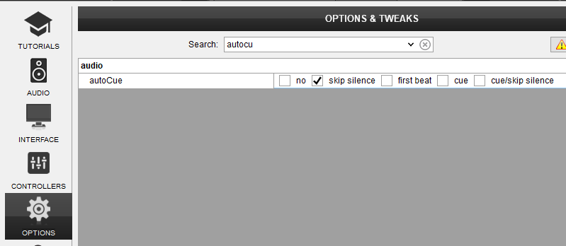

Please can someone help me how to set key for skip silence to star from the the beginning of the song (skip the silence)
Posted Fri 16 Aug 19 @ 11:55 am
It's actually a setting:
Posted Fri 16 Aug 19 @ 12:15 pm

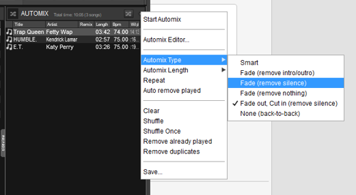

... and if you are running in automix mode, it's an automix type:
Posted Fri 16 Aug 19 @ 12:17 pm
