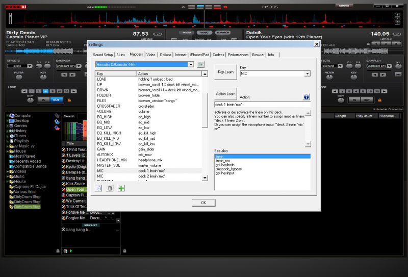

here is a screen shoot on the vdj mapping config.
Posted Tue 28 Aug 12 @ 5:03 pm

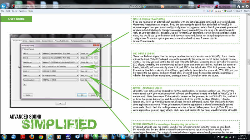

screen shoot of the control panel info:
Posted Tue 28 Aug 12 @ 5:05 pm
