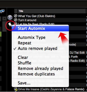

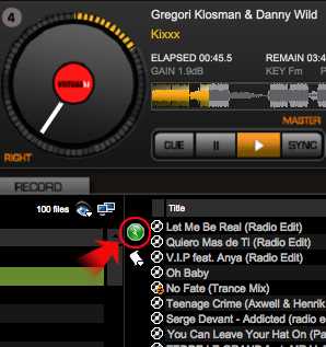

You have to click the red circle it will turn to Green when auto-mix is activated.
Then click the another red circle below to see the auto-mix option menu.
