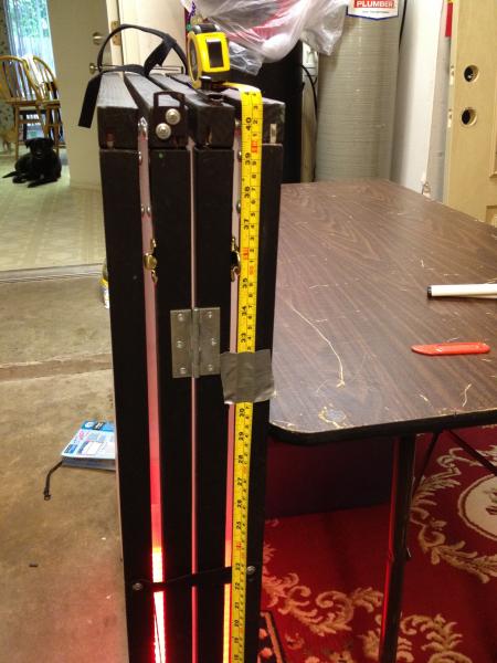

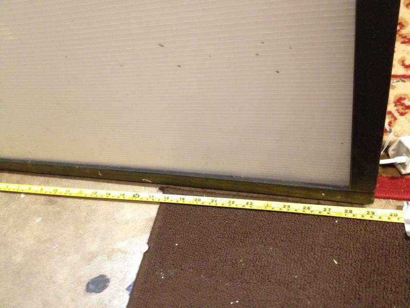

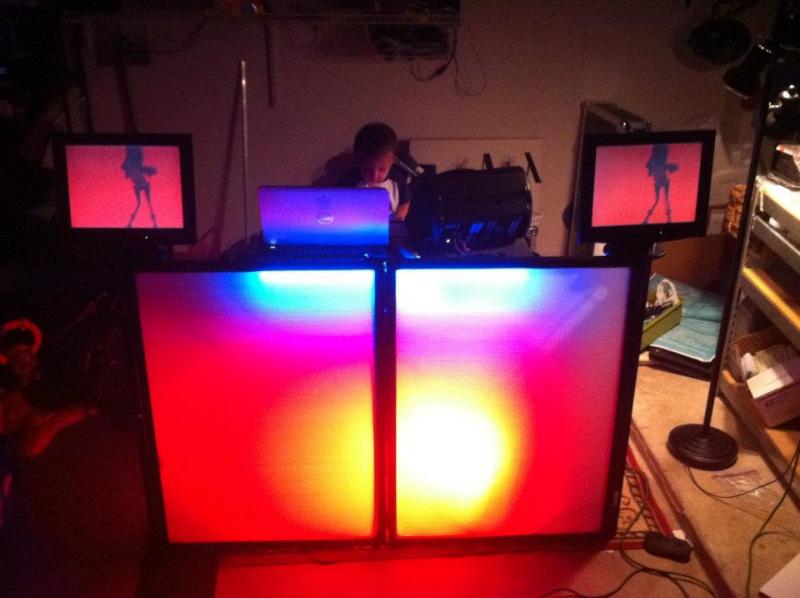

I built one out of a bunch of 2x2 boards, slotted the wood with a table saw, and used and 4x8 Sheets of 4mm Colorplast corrugated plastic($20). I am now using SMD 5050 RGB Waterproof 60 per meter LED strip lights($40 ebay). I think its better then fabric as it can be wiped down with a towel. It weighs maybe 15 lbs folded up. You can get a DMX controller for the strip light on ebay for $10

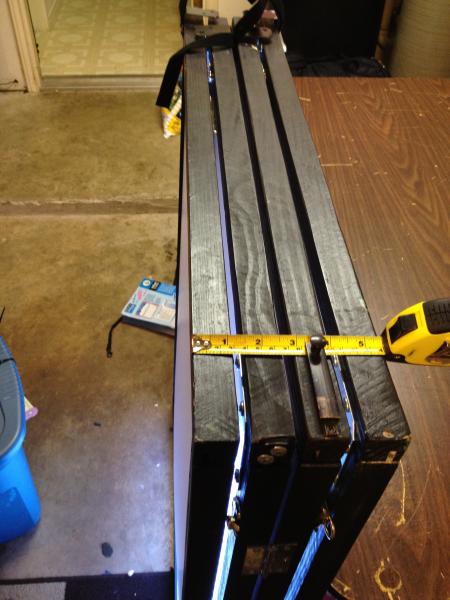

My only issue is, i would like to be able to handle, 4-6-8 foot table long. With the PVC/ABS Pipe, I could simply add a couple more pipes and it would be done. Also, when putting it down, it could all go in a light stand/speaker stand bag.
Have any images when its folded?

Looks to me like it's made of separate frames slotted together, so to make it wider you'd add frames.
Packed down, it'd just be the size of one frame x height of stack.

Great job David. Is this one piece, or does the sections separate? Can you show the hardware you used?

I built it using a table saw to cut, plane the wood and to slot it for the corrugated plastic. The front 2 panels are almost 5 ft wide. I originally made the side limited to a 90 degree angle, but now since changed to 45 degree so I can use it with a larger table. I am using it with a 6ft table right now. It is only held together with corner brackets and hinges for shelving and has some treasure chest type latches to keep the center from folder up. I plan on building another one in the near future, I will take get some more step by step directions. It cost me around $125 for wood and lighting. Took about 20 hours to build it. I think that now I know what Im doing I can do it in 1/2 the time.
-DJ Kavika
There is a closet locking pin by the measuring tape to help keep it from folding up
-DJ Kavika

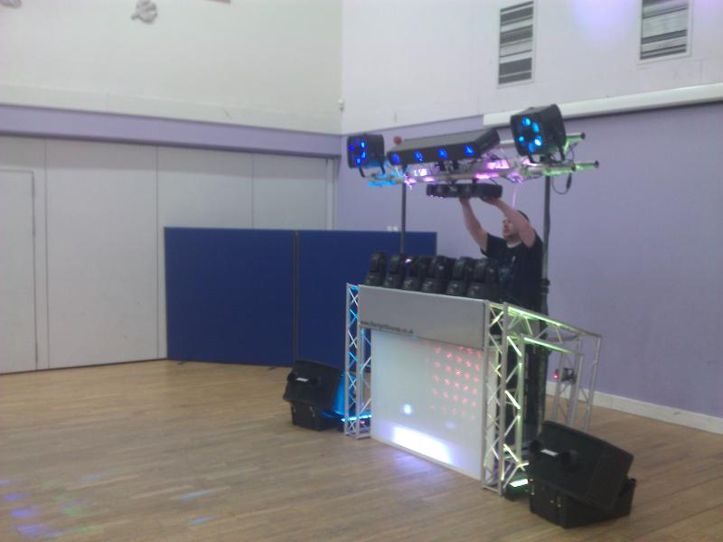

love the facade, i was thinking of building one myself as i\'m moving into more mobile work but then i saw this.. http://www.youtube.com/watch?v=jD-8BMuAktM,
costing £750 + vat in the uk it ain\'t cheap but i think it\'s worth it.

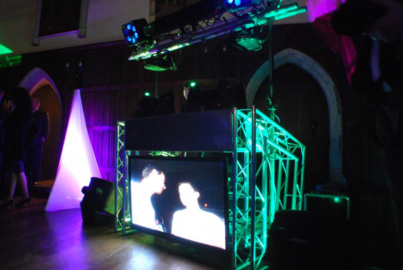

50\" tv with 2 led bars
white cloth with 2 small lasers plus 2 led bars
happy with this setup for this year. :-)
