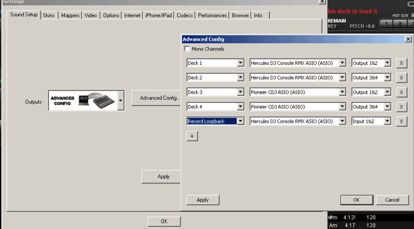

Hello,
So i tried the above configuration and nothing... :) here is a link of a youtube video i made of my set up... and a screencat of my VDJ options, i thought this way would be a lot easier to get the right help... thanks.
http://www.youtube.com/watch?v=O7vWdnpT6a4

Cubalibe gives you the right advise ;-)
Deck1 - CDJ Soundcard - Output 1&2
Deck2 - CDJ Soundcard - Output 3&4
Record Loopback - ONE OF YOUR SOUNDCARDS; WHICH IS CONNECTED AND HOLD A LINEIN - Input 1&2
You must now connect the Record/Booth Output with a cinch cable to your soundcard.
The one you will use as the LINEIN (RecordLoopback)
Now VDJ broadcast the LINEIN (RecordLoopback) signal!

Yep, you guys are right i was making a mistake with the recording... but its all fixed now.
thanks a bunch!
