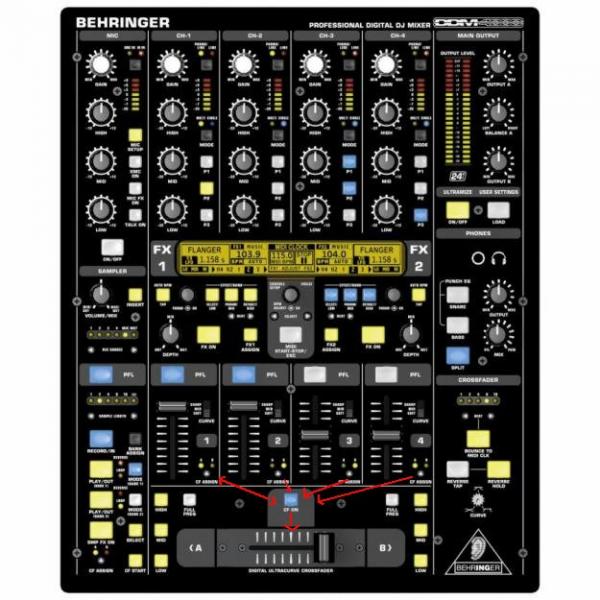

Hi , that part is mapped right , the crossfader works perfectly .
This button CF ON , is mapped with \"crossfader on ? crossfader off\" but is is not working on the mixer that option .
And to be honest without the correct code for it , the mixer will work with the line sliders on and the crossfader on also but the CF Assign lines like you explain to me before will not be usefull without this button working to activate that codes on hadware .
is abit confusing but is image ou will understand .
In image i dropped some arrows to be ndertanded how it works .
All those 4 buttons of CF assign lines will not work on Crossfader if that button on mixer is deactivated .
The crossfader is working as video only on virtual dj and the link on vdj \"Link bith streams video + audio to same crossfader\" are not doing nothing .

that looks like a hardware button to me, as in it affects the hardware not the midi... check the manual for how to set it up properly, but you should just be able to turn it on and have the crossfader work (if it is hardware)
for the mapping of the crossfader try
crossfader & video_crossfader
if you want to use that button if it is midi
toggle 'cf_on'
crossfader with the on shift
var 'cf_on' 1 ? crossfader & video_crossfader : nothing
the led would be
var 'cf_on' 1 ? on : off
toggle 'cf_on'
the led would be
Posted Fri 15 Jul 11 @ 9:18 pm
thanks , it is working perfect as you said .
I am working on the lines left that i can to release this mapper on VDJ site as standart mapper for behringer ddm4000 .
I was looking and users adapted their mappers to their needs , like (starting decks , pause decks , effects,etc...) , most of the things that are not complemented in standart behringer mixer .
I am using other decks codes to program their pars , as 1 is same as 3 and 2 as 4 .
I will like you at the end just give a quick look to the mapper itself and problably fix some lines iif they are wrong , of corse in case you want to waste time on it .
I believe this is important for all us here , because Behringer dont care about this stuff , and many users have same problems as i have/had .
I dont have pre listen on the mixer like i told you before , using crossfader is the same (in internal mixer) as using only the slider buttons for each channel.
Example : having to decks in input lines 1 and 2 , the crossfader is turned to 1st deck , the line 2 inputs are at 0 sound in in mixer until i get crossfader to other side .
About that i believe it cant be do nothing by scripting in vdj .
