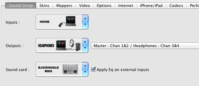

- As for audio, use the following configuration:
