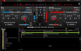

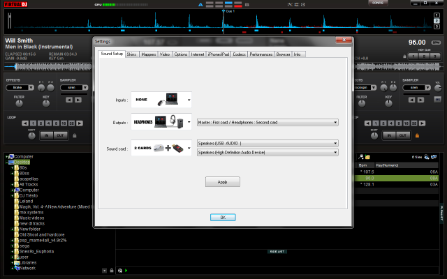

thanks 4 replying this is how i have things set up :
http://i279.photobucket.com/albums/kk134/Ryan_Guppy/vdjsetup-1.png
http://i279.photobucket.com/albums/kk134/Ryan_Guppy/vdj2-1.png
at the moment , i dont have a midi controller so just using the laptop (keyboard) . to get cue mix on controlllers i usually just remap a control/slider or whatever to headphone_mix . i just cant get it working with two separte cards not sure why . i think it might be that the cue button is acting as headphone volume not headphone mix on that skin , cant work out how to change it . usually have no probs at remapping when i have acontroller . i dont know what keys on the keyboard control the cue heaphone volume cant find it on the mapping list ggggrrrr

Ok try for your headphones choose "Primary Sound something" and see if that works. I know on mine if I choose the wrong one it won't work aswell. You might have map it but I don't think with the le version your allowed to do that.....
Let me know, we'll get it working :-)
Huey
Huey
Posted Sun 12 Jun 11 @ 9:00 am
thanks for your help , ive just tried a vestax typhoon with using 2 sound cards and it works fine . i didnt use the sound card thats inside the typhoon just used it as a midi controller , so yeah like you say it doeswork.so i can now go out and get a midi controller that i like :) i quite like the look of the gemini ctrl one . i will only being doing house parties if any so no point spending more money on a a controller with a sound card in .
