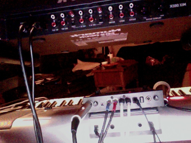

The Numark Mixdeck is plugged into my Mac USB.
(Note: My Mixdeck has not working properly for some reason so I have to use my auxiliary port (headphone out) out of my laptop and it works fine that way. No audio comes out of my Numark Mixdeck though :/ )
Next I have my Yamaha PSR E403 plugged in to the other USB.

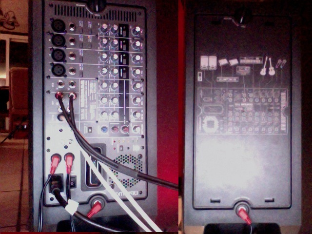

I have the auxiliary port (headphone out) plugged into the input of the Korg Quad Kaoss Pad. From the output of that into the Samson 550i PA input (This is done with a 1/8 to RCA R&W)
When I play the keyboard I am only getting sound out of 1 speaker. Anything I touch on my mixdeck will play the sound sound that the keyboard is making because I have Logic Pro running as well as VDJ7. Pretty much anything I touch as far as platters, cue, play, pause, fx, loops, etc....it all makes the sound I have selected in logic.

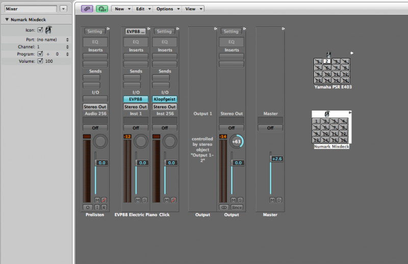

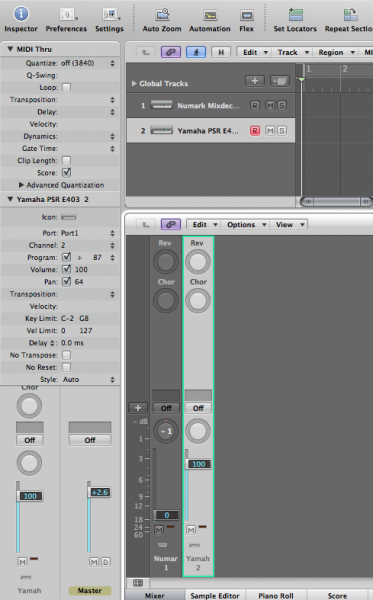

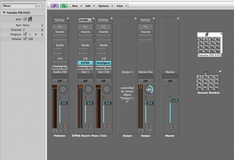

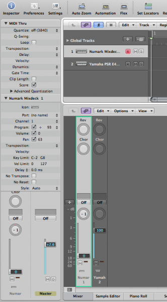

I have also tried setting up different MIDI ports in logic by hitting apple 8 selecting new multi instrument and putting the mixdeck on port1 channel 1 but the problem is when I try and put the numark on port 1 it says (No Name) and the keyboard says Port1. I'm not sure why that is.
I have then went back to Logic's main screen and created 2 new external midi instruments and neither of them make any sound.
When I create a software instrument both keyboard and mixdeck make the same sounds when touched in anyway....(You can see why I'm frustrated with this)
