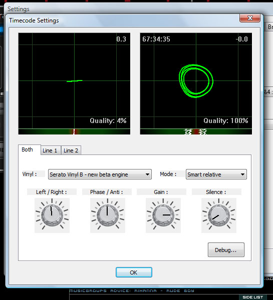

Huey,
That was exactly what I needed. I have sound!! one more issue though. The left side is not getting 100% and when i touch the record to hold it, the song continues to move. Here are some pics. In the manual it says that the line describes my right side not getting a signal, check the cords or the needle. The needle is brand new and the cords are tight, as you can see the right side is playing fine. Thanks again

Are you using the Serato B side? That's what you have choosen in your pictures.

Edit, turn up your "silence" knobs just a little bit more and see what happens. Let me know......

@ Huey yes I am using the Serato B side. I switched to the A side and I get the same issue. When I turn up the silence knobs, I get no music, that's why I have them turned all the way down.
@ Heiko, I am using line because the phono input provides a loud tone. I've checked the cables and they are all tight.

did u check ur needles? rcas?
