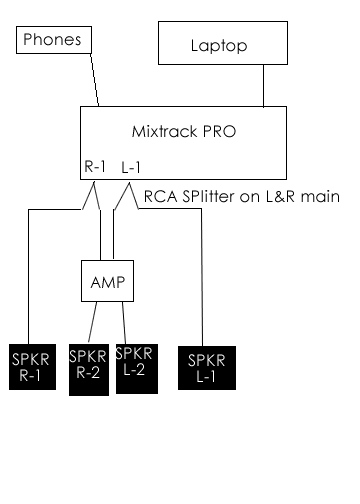

Hte mixtrack pro is an odd beast. the 2 outputs don\'t work the way you think they should. re-read the owners manual -don\'t have mine in front of me - I believe one is only good for cueing so you can\'t use it if you have headphones plugged in. that is why you will need splitter cables if you are running 4 speakers. Ran mine that way for a while but eventually just pulled the plug on the 2nd set. what kind of set-up are you running? You have 2 powered speakers and and 2 passive speakers on an amp? Do your powered speakers not have pass through outputs? What is the physical arrangement? are they in separate rooms? What model speakers and amp are you using? In my experience with the Mixtrack pro RCA splitters from the main output are the way to go. You have to separate your RCA cables into single strands though to run the L/R to the proper sides and keep them color coded.

Mixtrack pro is great to start with - Check out the diagram I posted earlier in the thread and remove the 2 extra speakers and splitter.
