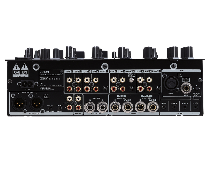

There are not a lot of mixers with a dedicated channel for effects. I've found 1 on the Denon site, the DNX1100:
As you can see it has got an Effects Send and Return. With the Send-connection you "feed" the KPQ with signal coming from the mixer. Normally you decide what the KPQ gets by opening a volumecontrol in the mixer channels. With the Return-connection you put the effects back into the mixer. There you can control how "wet" the effects must be. This means that you can add the effect from a little into the music until maximum. For some of the effects however it is better to give the control to the KPQ. With it's effect control you can completely shut down the music and let the effects be your source of sound.
