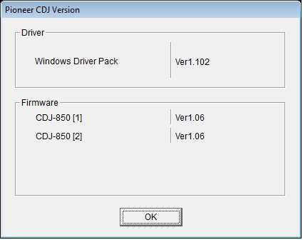

          Are you running firmware 1.06 on them? If not pop over to pioneer site and download. I have the 850's and it is the same update for both, and mine are running sweet as.
Hope this helps,
Ian

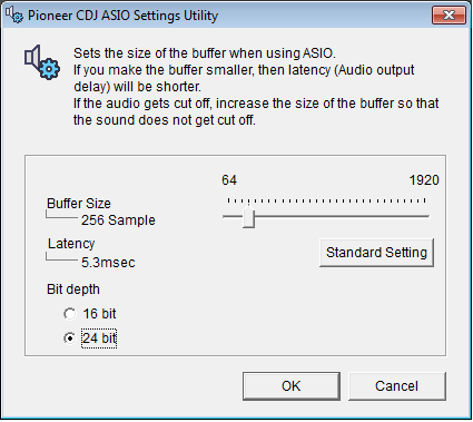

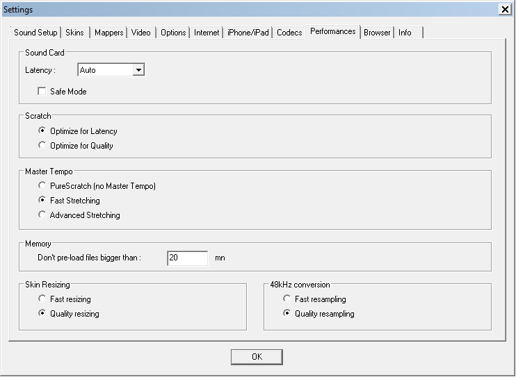

          I am only running a  HP ENVY 13 core 2 duo 1.86, 6 gig ram on windows 7 64bit, and have no problems at all with VDJ 7.0.4 music and video with plugins running.
You might need more ram which is cheap these days, anyway here are my settings :
VDJ SETTINGS
PIONEER SETTINGS
Hope you have more luck this time

          I have run on 3 with no problems, so I would go for 3 as a minimum if you are thinking of getting more ram. But before that try putting your latency up to 512 on VDJ and in the Pioneer options first, to see if this helps. I would also put a ticket in with your problem to the team, they are really helpful and might be able to sort you out.
