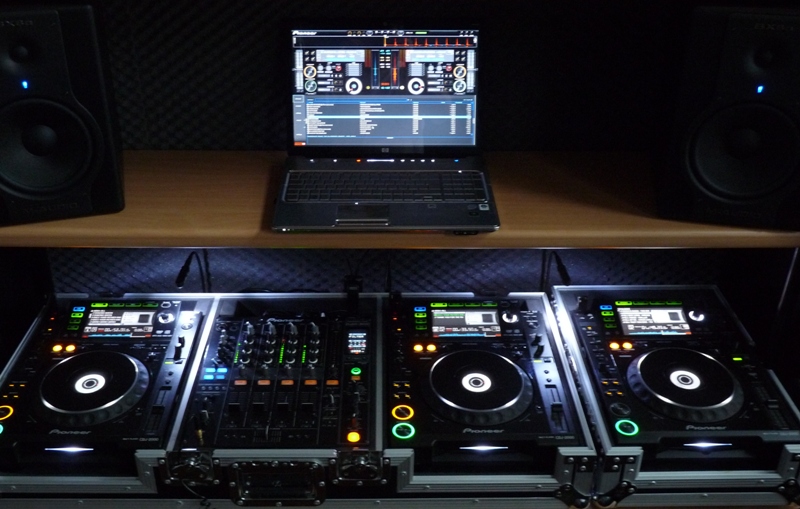

This is a photgraph of my set Pioneers cdj-2000 with virtual Dj (Pioneer pro skin)
Grts Frank
Grts Frank

Frank that set looks perfect, and you use the best skin !
Would you like to change anything on that skin ?
