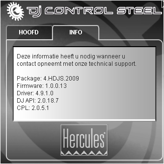

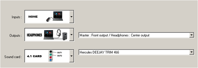

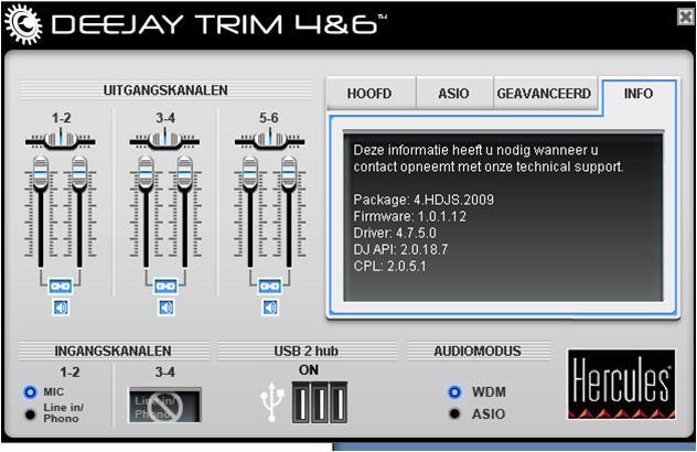

In virtualdjv 6.07pro the sound setp does not work properly when I select the Deejay trim.
I am using the Hercules DJ steel with it.
Diriver versions below for the
steel and the trim
To mee it looks like a bug,because when I select the 4.1 card, it does work.
Probably this is also why other features do not work, like ASIO. When you start VDJ, it forces the Trim into WDM mode.
Freek
steel and the trim
Freek

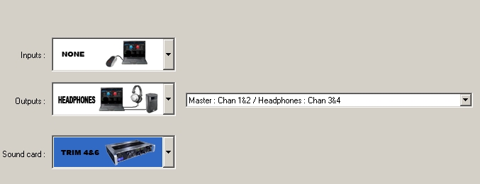

When you say it doesn't work properly when selecting the Trim, what do you mean exactly ?
The normal behaviour should be as follow:
1)
- Input : None
- Output(s): Headphone
-Soundcard: Trim
> The soundcard operate in WDM mode
2)
- Input : 1 or 2 timecode
-Soundcard: Trim
> The soundcard operate in ASIO mode
If you want to use the Trim in ASIO without using timecode, you will have to :
- Open VDJ
- Select a soundcard other than the Trim
- Close VDJ
- Switch the Trim to ASIO in the control panel
- Open VDJ again and configure as
- Input : None
-Soundcard: ASIO > Trim 4&6
Once this is done, VDJ will remember your configuration so you don't have to do it everytime.
1)
- Input : None
-Soundcard: Trim
2)
-Soundcard: Trim

I mean the headphone does not work, the main audience channel does.
I will try your suggestions and report back.
freek
freek

Tried suggestions.
Using ASIO it working properly including headphone and microphone.
Using WDM neither the mic nor the headphone do work.
freek
freek
Posted Wed 17 Mar 10 @ 5:49 am
Interesting... I get the problem also. It seems to happen if the Trim is set to 2x6 mode. The headphone seems to works correctly when in 4x4 mode.
Posted Wed 17 Mar 10 @ 6:44 am
