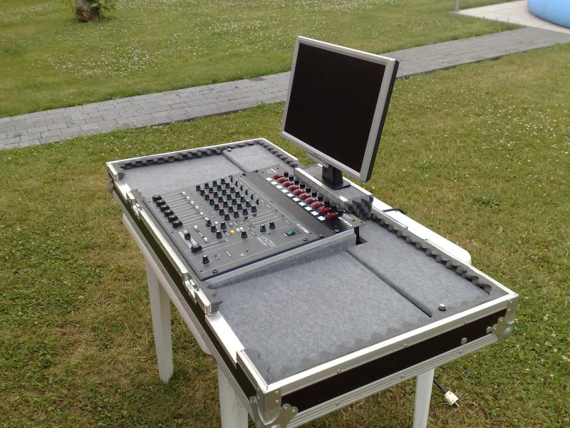

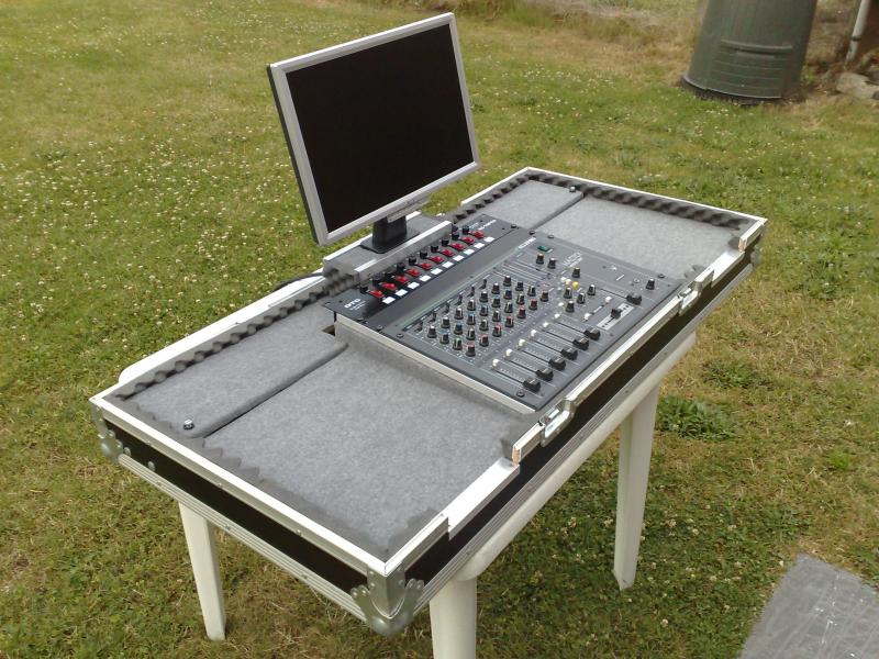

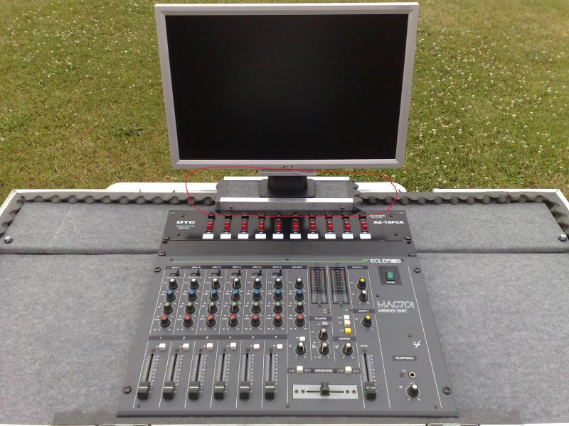

Nice looking setup, didn't see any wires how you connecting every thing? is there a pro connection or is everything just plugged into muli plugs somewhere? what mixer was that?
Posted Mon 04 Jan 10 @ 6:42 am
Hi,
Thx for you feedback

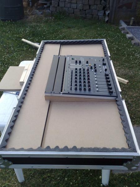

See here picture from how i make the coffin
http://djcb.musicblog.fr/1152065/Construction-Flightcase/
Connection, power is here
Thats very clean and you see nothing from connection, power.....
The mixer is Ecler Mac 70i (Very good mixer and is a studio mixer)
Bye
Bye
Posted Mon 04 Jan 10 @ 12:39 pm
Hello. Did you make everything? The bottom structure?
Posted Mon 04 Jan 10 @ 12:50 pm
Yes
Posted Mon 04 Jan 10 @ 12:52 pm
Nice! Did you save cash or was this a "this is what i need and want" project?
Posted Mon 04 Jan 10 @ 12:53 pm

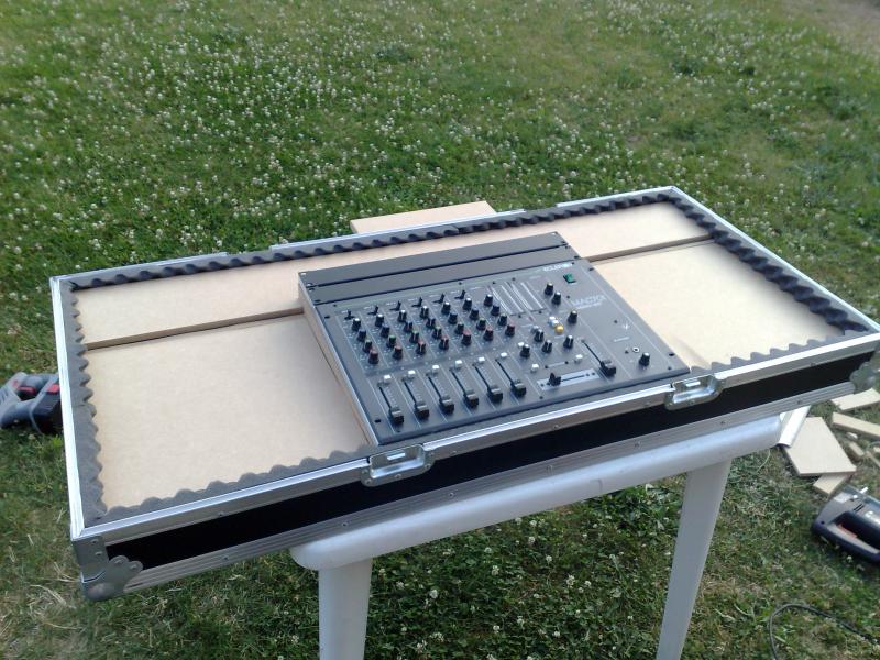

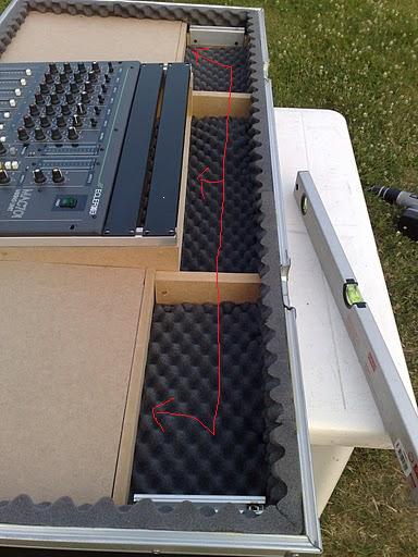

Yes i save cash but this is a coffin that i will create.
First i make the bottom structure
I take the measures of my denon and mixer
Then when I had finished the structure, I had a plan in my mind.
Than modify to finish it and you can see the final coffin
Same for support from my lcd, who can come out easily
And here more picture from the coffin
Posted Mon 04 Jan 10 @ 1:50 pm

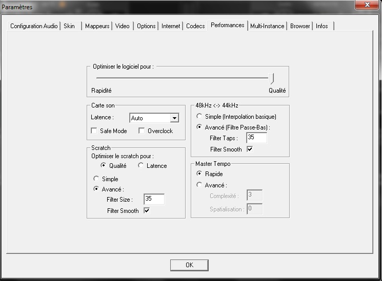

I have test the settings from the forward page but platter is not responsive as it should,maybe you are not a scratch DJ like me, still playing around the settings to get the platter to feel just like I am using timecode.Maybe we need an update from the VDJ team with platter improvement as soon as possible.
