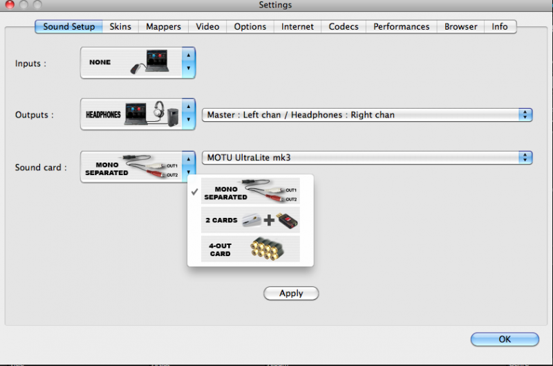

hi daz, i just pm... i attach my vdj config... im just frustrated cause i dont know what to do.. is this config in vdj correct?
Im using just my macbook, the motu ultrallite mk3, the headphones, my mic and my pa speakers... simple arrangement...

This config looks wrong.
It shows as two cards when I think only one should be assigned. When you select "external mixer" it should show left deck 1 and 2 right deck 3 and 4.
If you want your headphones and both decks separate then select "3 lines mixer" and in this setup select left deck 1 and 2 right deck 3 and 4 headphones 5 and 6
In the MOTU audi setup panel it is also showing your headphones selected to 1 and 2 when it should be 3 and 4. or 5 and 6.
Just for a start.

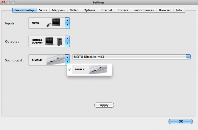

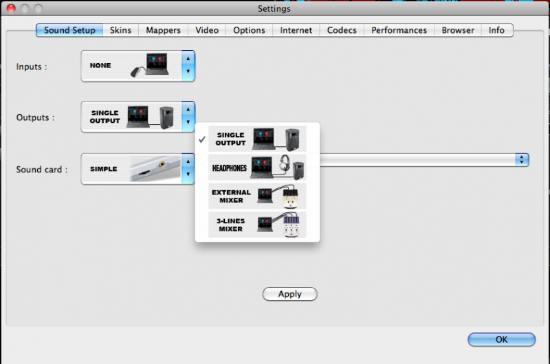

jajaja.. oks.. lets start from the begining; what i got its the follow:
Macbook pro @2.8 with vdjpro
The VCI-100 ad the midi controller
The motu ultrilite mk3 as the audio interface
PA Speakers
1 Mic
1 headphones
thats all i have...mentioned that... what should i select in the config sound set up.
i just change to a single output....these are the options:
Posted Sun 29 Nov 09 @ 2:25 am
OK
Inputs leave as none
sound card "not shure but should be an option for the motu" (pop up a pick of the options)
Outputs set to headphones
make your settings in the above order
when you select HEADPHONES on the outputs tab you should get an option menu. In this menue select MAIN 1 AND 2 HEADPHONES 3 AND 4.
Once this is done we will need to see what options you get on the Motu sound setup so that the headphones can be assigned correctly in the CueMix FX.
For once I do actualy have all day to work with you on this and have just made a nice hot cup of coffee so I will try and stay logged in.
This is going to be a slow process as I need you to put up pics at each stage to show the options for the next stage but we will get there.
Daz

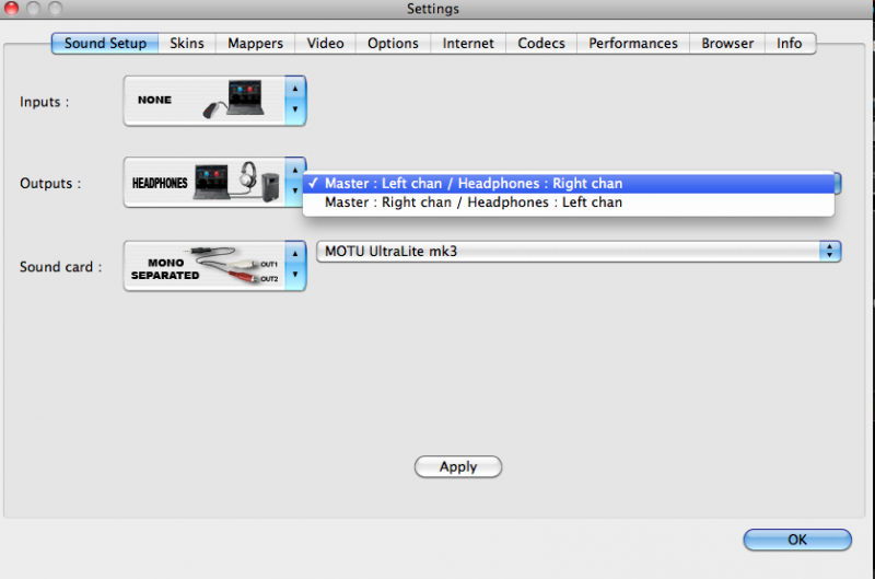

oks daz.. i just selected the headphones but in the outputs tab there are just these options(below) ... by the way if i select mono separated i can pre-listen but in the right side of the the headphone only...its a good step for me ..at least i can cue but with one channel jejejeje lets findout how to run the other channel. theres no 1-2 and channel 3-4 channel option available
Posted Sun 29 Nov 09 @ 2:53 am

OK
select 4out card.
Then go back to the HEADPHONE SELECT.
select 4out card.
Posted Sun 29 Nov 09 @ 2:59 am

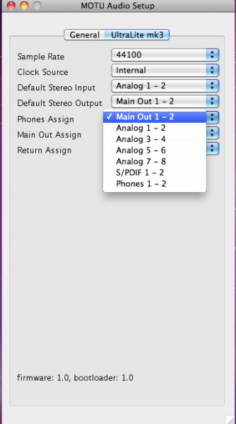

Ok lets take a breath,
We have to do this step by step and this means seting up VDJ first then the Motu. We will worry about how the speakers are connected soon. I have to ask you to take your time and do this one sep each post with no testing or change of settings between steps.
What we have done so far is to tell VDJ that it has a 4 chan sound card and also which channels of the card we want it to use for the master and headphone outputs.
Next step is to configure the Motu.
Can you bring up the Motu audio setup menu and post pics showing the options that are displayed for all the settings in this menu. 1 pic per item in the menu.
Posted Sun 29 Nov 09 @ 3:42 am

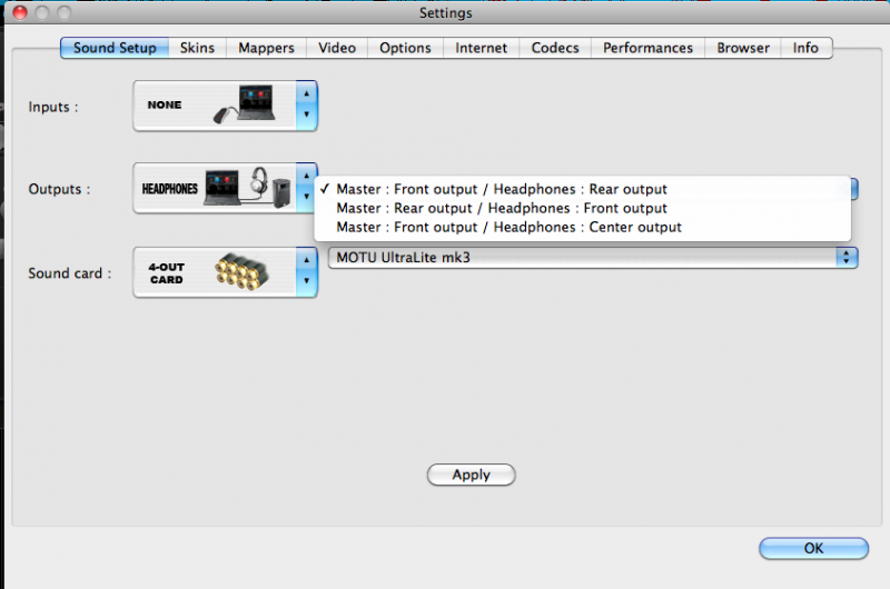

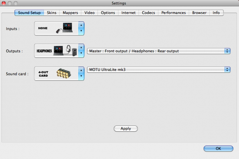

oks ready to go again... 11:00 am here jejeje. i just changed the the vdj config. heres a resume...
Outputs: Headphones; Master: Front Output; Headphones: Rear Output. (For some reason vdj doesnt allow set in the other way around(Master Rear and HPhones Front; always return to the Master: Front Output; Headphones: Rear Output set); nevertheless when i put Master Rear and HPhones Front and push apply the only volume that works is the cue knob from vdj; in the other case Master: Front Output; Headphones: Rear Output, the main volume is which work only.
Sound Card: 4-out card

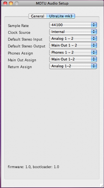

The motu set up (i do't know if the phones are assigned properly) is as follow :
About the PA sub-wofer connection i do it in the rear side in the mains outputs (L,R) and then daisy chain with the pa speakers. and the phones jack is in the front.

Ok mate
On the Motu setup menu select the headphone assign to analog 3-4.
Posted Sun 29 Nov 09 @ 12:16 pm
i just did...then...
Posted Sun 29 Nov 09 @ 12:21 pm
Ok now forget moving the speaker connections jus leav them in main out 1-2
Check to see if the headphone signal is comming from the CUE vol control and the master volume is now only comming through the speakers.
Posted Sun 29 Nov 09 @ 12:25 pm
