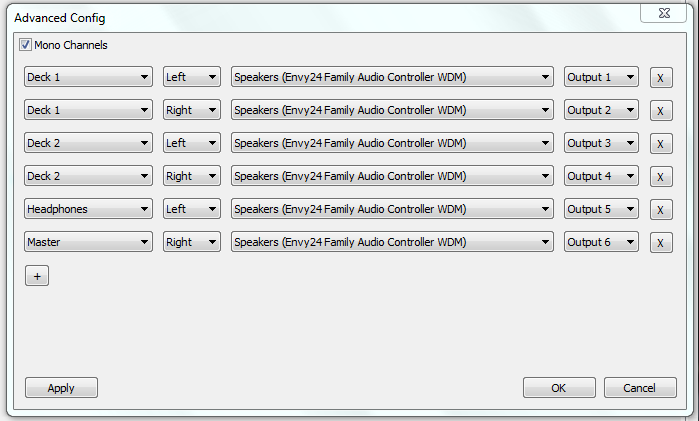

Sorry, VirtualDJ does not currently support split cue. However, you can in most cases achieve this using advanced sound configuration with mono channels. Please see http://www.virtualdj.com/wiki/Split%20cue%20using%20advanced%20sound%20config.html
Another option is the Denon MC6000 - This is a both a hardware DJ mixer and MIDI controller in a single unit, so when configured in hardware mixer mode (Outputs: External Mixer in VirtualDJ and INT MIX setting on the back of the MC6000), you can use its hardware mixer's built-in split cue capability.
NOTE: Split cue capability within VirtualDJ itself may be added to a future version of the software.
