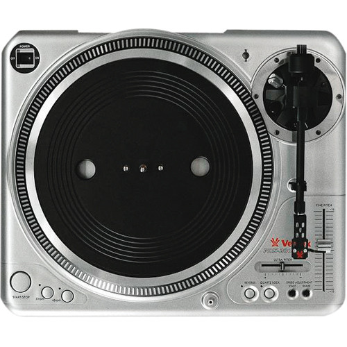

It would, in a way act like this old Vestax but no need for a ultra pitch cuse vdj would do it and leave my pitch fader at the pitch i choise (which witch is like the sl 1200)
