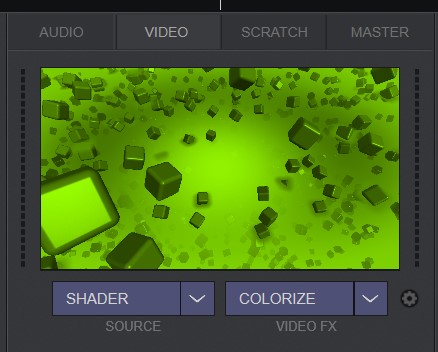

is it possible to map the "color" parameter in the "Colorize" transform to 2 buttons on the keyboard - "up" value & "down" value- or an encoder on a midi controller.
with the mouse the change of values is to fast (5 or 10 numbers every step sometimes) and i could use a more precise control over it .
I need to get some colors to a almost precise value

If it's selected on the master deck, and turned on (like in the image above), you can use:
deck master video_fx_slider 1 -1%
and
deck master video_fx_slider 1 +1%
You can of course choose a different percentage for bigger steps

you are a lifesaver !
it worked with 0.2 % for increments of 1
thanks a lot !!!
thanks a lot !!!
