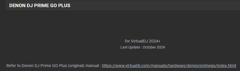

Partly why I've mentioned this is that the VDJ setup guide for the GO+ simply says to refer to the original GO manual (but incorrectly calls it a Plus manual).

Manual text updated
