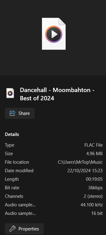

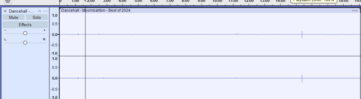

I have the newest virtual dj build... I have tried recording 2 dj mixes ( one in Wav format and the other in Flac) and both do not work. They have the full recording catalogued but no data stored within it ( the flac is recorded in 36bt which doesn't sound right). I loaded the Flac in audacity and the mix is literally blank yet lasts the full duration (over 19mins). Is this an error with the latest build? Some pics for more info and proof:
(Note it records, saves and loads files fine - just a blank file each time currently)

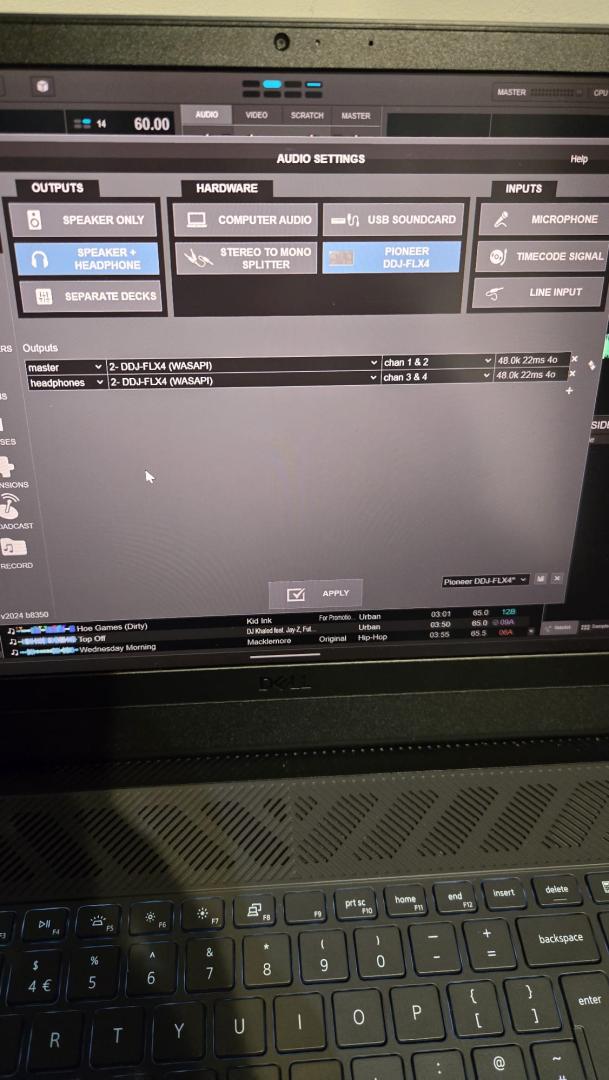

Like this? Worked fine in the past for recording them settings...

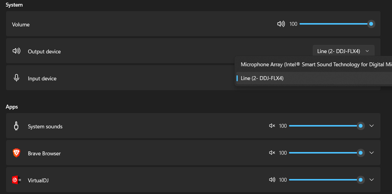

Check the record volume in your windows sound settings for WASAPI drivers.

Looked at the manuals, that's the default settings for virtual dj when connecting with the flx4 so isn't that. Checked my sound settings and all seems fine. Looked at my previous mixes in FLAC and the only difference is the bit rate, everything else is the same... I did a mix over a month ago in WAV and was no problem with that. All that's changed is me updating virtual dj to my knowledge. ALL my previous mixes still load fine and can hear the mix so my laptops mic recording input...just any new ones I make don't... plz help

I wouldn't have thought using a different bit rate for recording (on the same interface) is correct. I think that's more likely to be an error in the setup guide.
Also you shouldn't have the FLX selected as your default in Windows either.

(I see you posted a screenshot of the output volume in windows, but not of the recording volume, so that's still a possibility)

@adion I have fixed it. But I don't understand how. It worked with these audio settings
everytime the flx4 connects record input is automatic...does that mean I have to remove it every time I wish to record? Doesn't make sense as thats the automatic setup. My mic and drivers are all up to date.

Yh i know. I was hoping you'd explain why it doesn't work when the record channel is included that was 44k...because that is automatically setup each time with flx4 yet that is when it doesn't work recording audio.

You could try changing it to 48khz in windows to see if that makes a difference, although either way should work.
