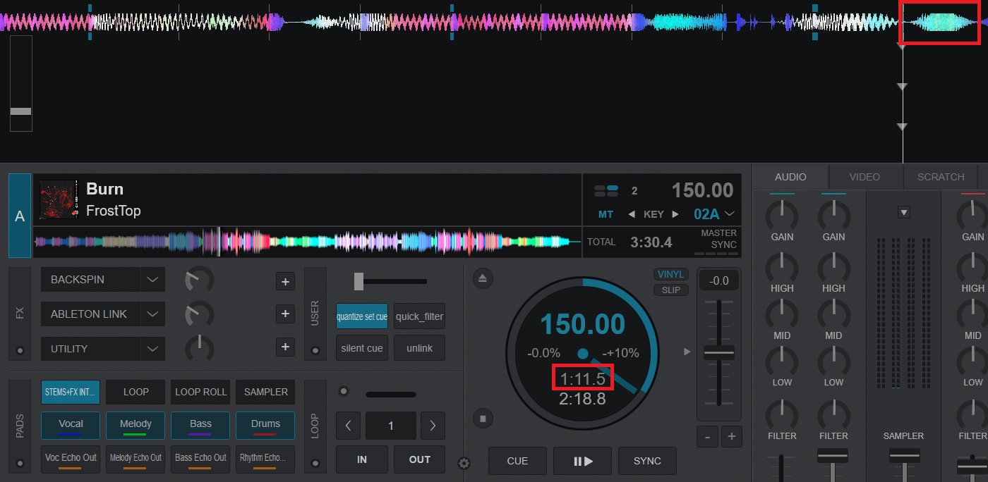

Here is the specific synth shot waveform highlighted in red:

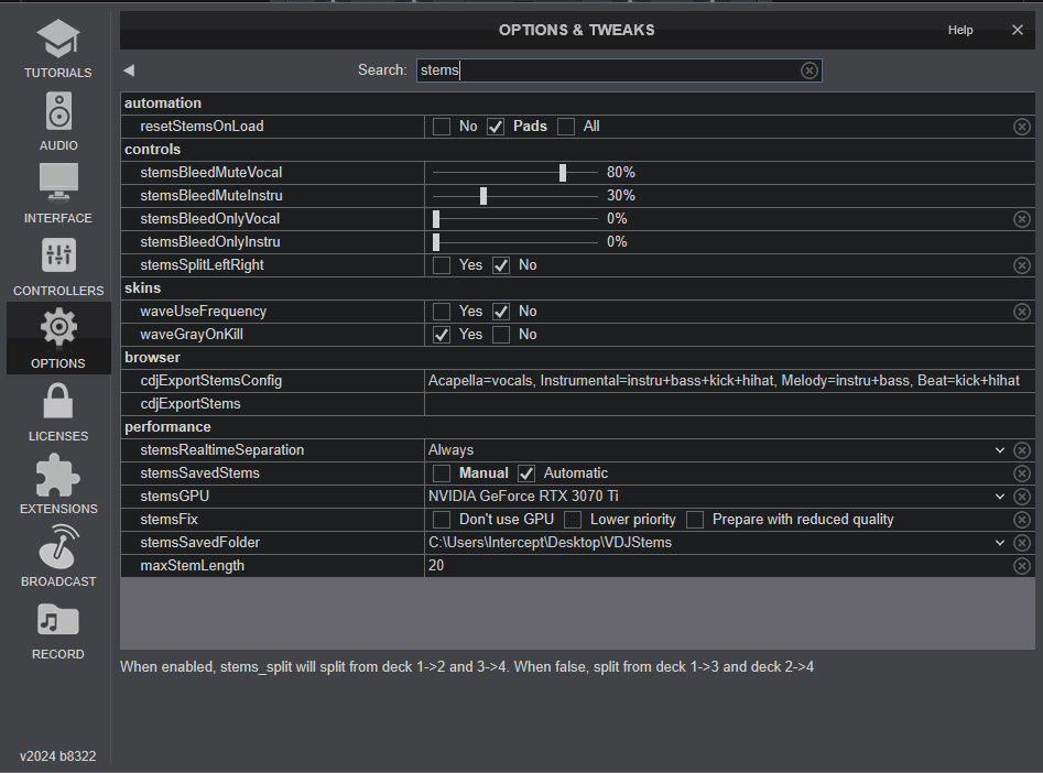

Here are my stem settings:

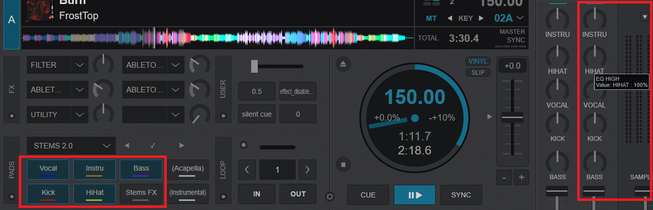

I double checked that all stems are set to 100% using 5-stem EQ mode (unplugged controllers and double clicked to set to middle, hovering to verify 100%) and all pads are enabled. Is there anything else I can check on my side?

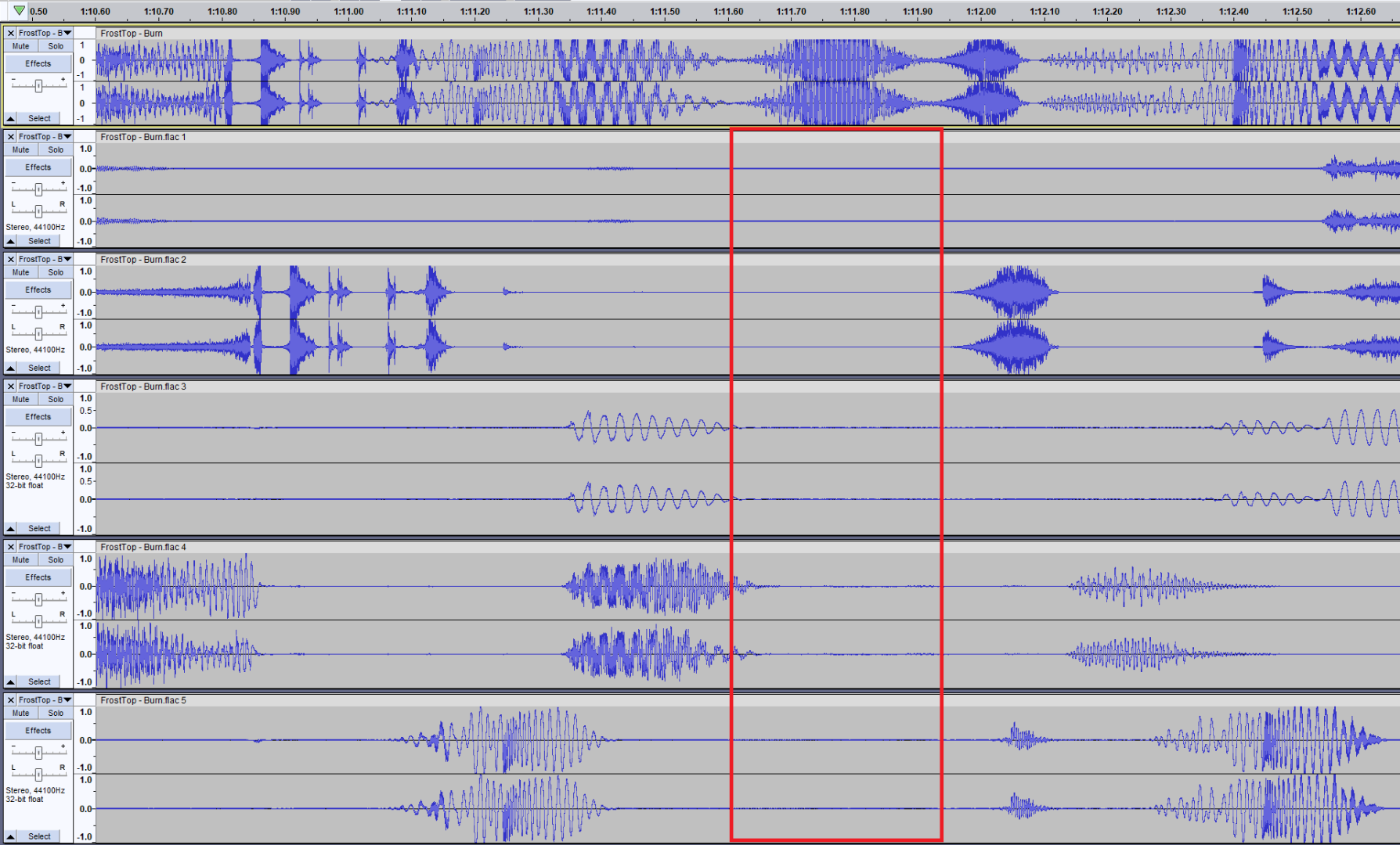

As an aside: looking at the full track (top) vs stem files I'm surprised to see that it's possible for audio to not be represented in any of the 5 stems. I'd expect summing all the stems to get pretty close to the original song, but I'm surprised it's possible to get near silence in the sum of the stems when there's content in the full track.
