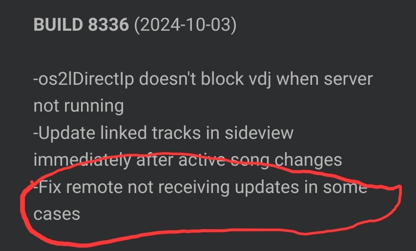

So I've noticed that b8336 has a well awaited fix wrt the Remote:
It works really well with Linked Tracks and updates to the Sidelist.
It doesn't work well with these cases:
I can only get them to update by switching focus to another folder and coming back. This is big, especially for the second one (ask.the.dj), because it means I cannot reliably use the remote to track song request updates without switching to another folder.

Ask the dj updates and updates to folders other than sidelist/automix/karaoke is indeed not working yet
