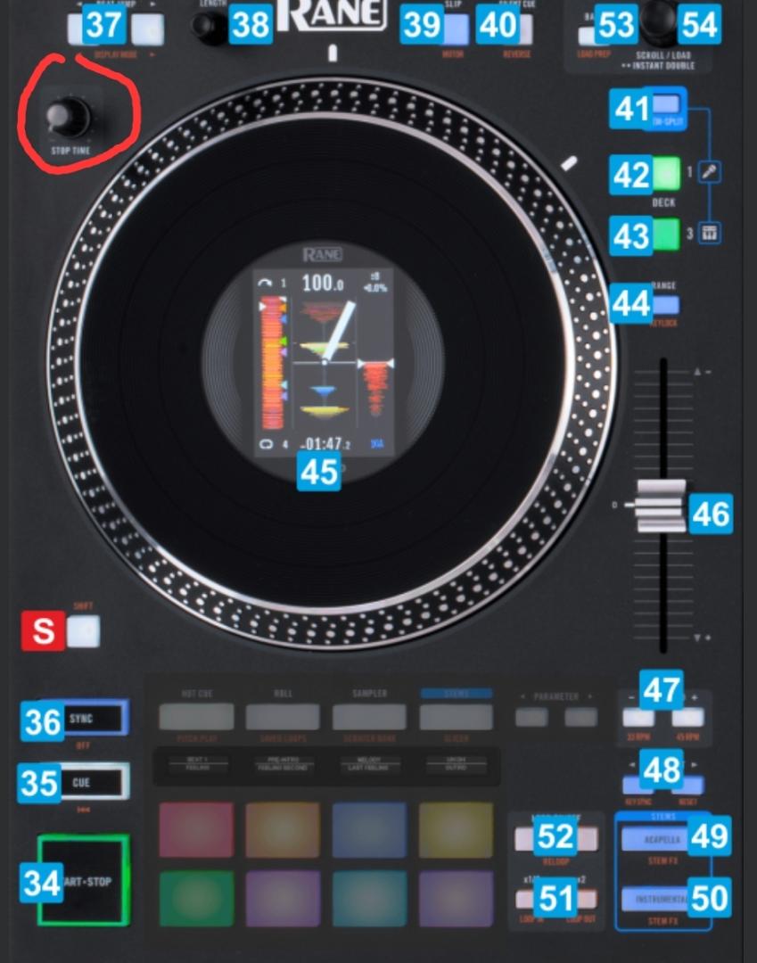

What is the stop time knob set to for that deck:
If it's not already all the way left and you want the fastest time possible I guess you'll have to turn it all the way left.

It's all the way to the left. it's set to 0.0. I've also tried restarting my rane performer and virtual dj. the platter keeps spinning on that side as well

@KingRanch318 This is normal for turntables - you have the stop time (upper left knob) greater than zero, so it takes the platter a bit of time to slow down. Decrease the value to decrease the stop time. Some Super OEMs have controls for both start and stop times and OG technics SL-1200s had no controls for this, ad here was a noticeable start and stop time there.

Correct I know how the stop time knob works and its function I use it all the time. I’ve actually missed having it. On other controllers.
I’m talking about the little nudge almost like mini scratch that happens right after I hit the button. Before it starts slowing down.
I didn’t think that was normal.

You are right, on closer inspection that does look weird.
Check the answer @Adion recently gave here
Summary: try turning motorWheelInstantStart=No (it's on by default) to make the startup playback behaviour follow the motor startup.
