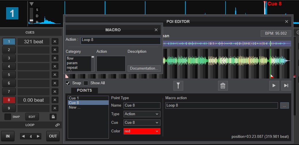

Easy fix with Poi Editor.
Check the Picture below.
My tip is to change the color to red for an example in the end loop, or green to the intro loop ;)
Just type in Loop 4 , 8 or how long or short you want the loop into macro action.
