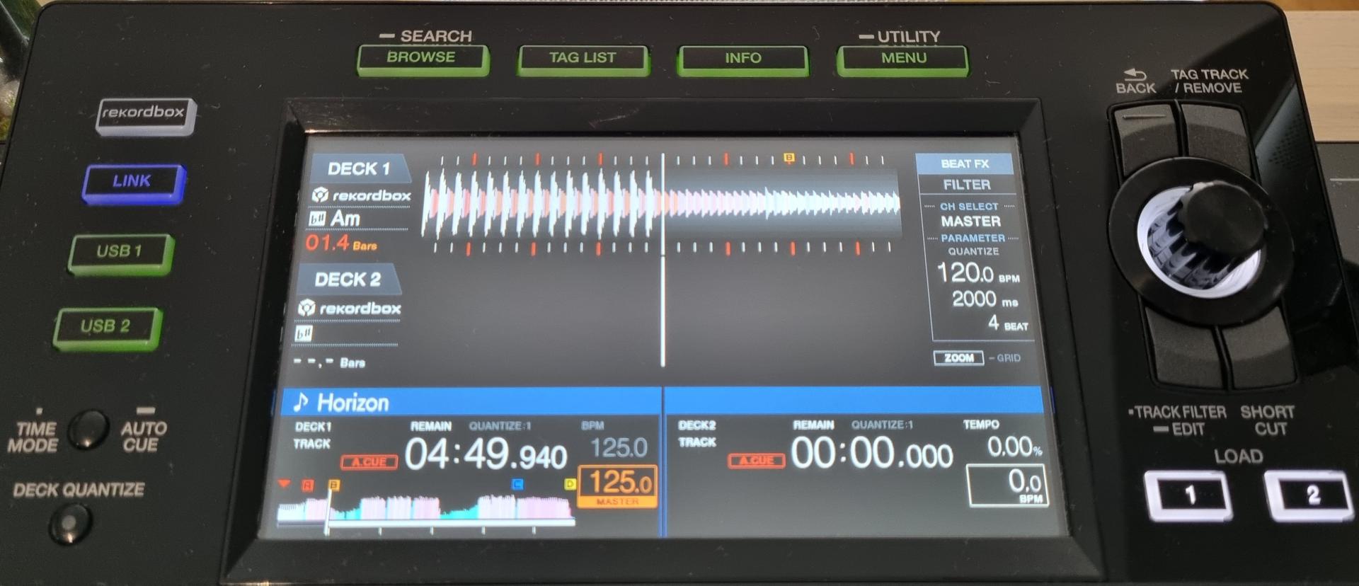

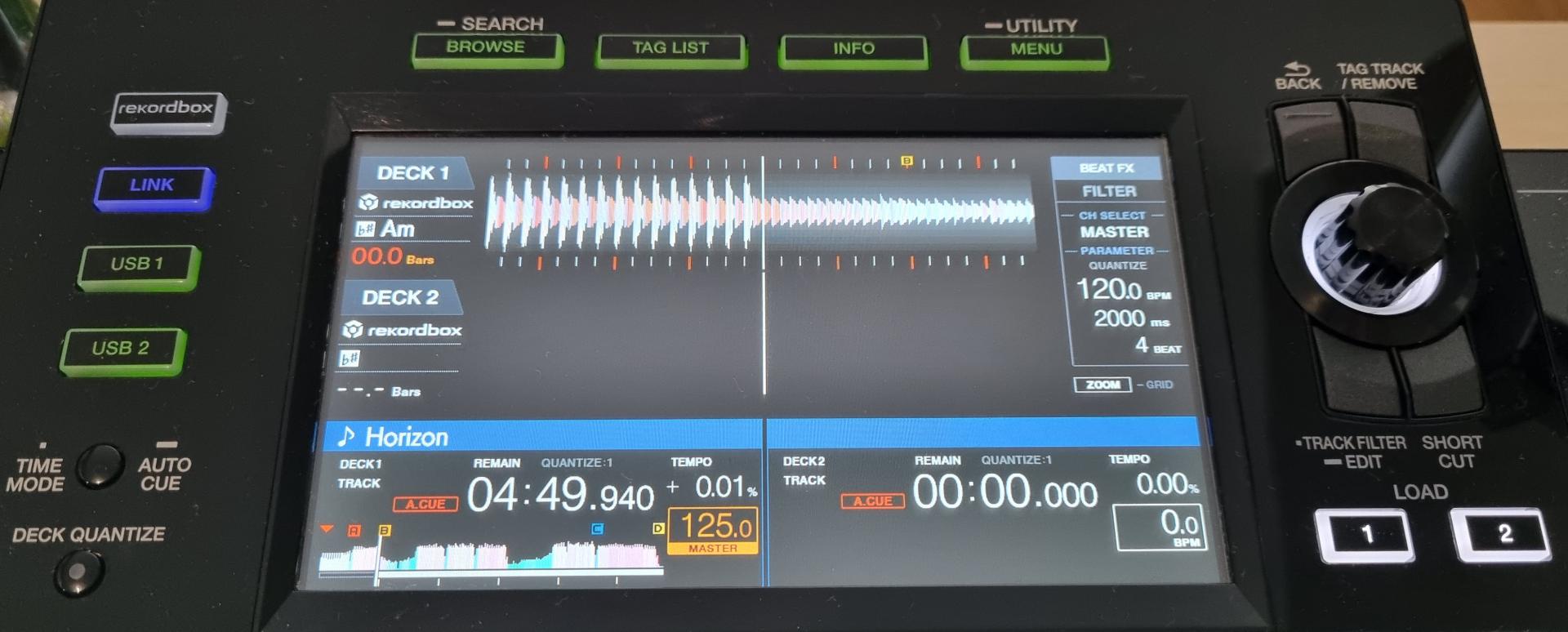

1. Build 7921: I am 8 beats close to the next hot cue (B). Bars displayed: 00.0.
2. Build 7831: I am 8 beats close to the next hot cue (B). Bars displayed: 01.4. (Same track, by the way.)

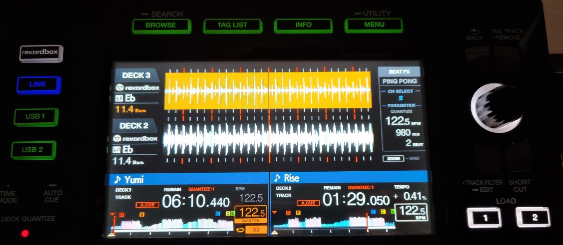

3. This is just a random example, to show you that I rely a lot on this bars display, to determine exactly when I want to mix into the next track.
To confirm the issue, I have manually downgraded to the former build, 7831.
Then, I have re-install the latest build, 7921, then back again to 7831. In-between, I took these examples in photos.
