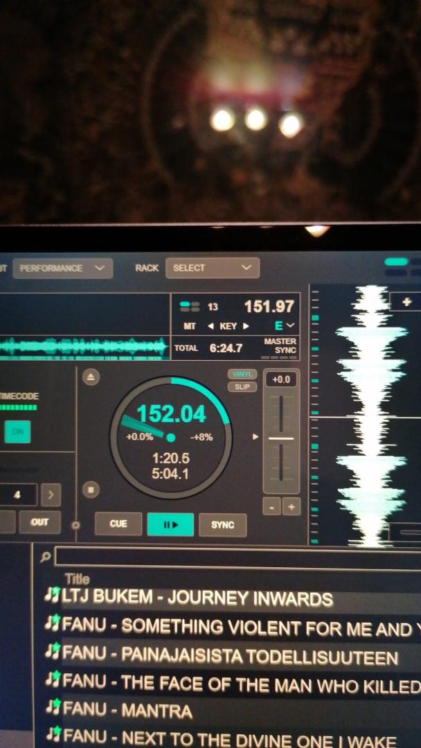

Hi,
Recently acquired a VDJ license as i was recommended to give it a go by a good friend. I own a Rane Seventy MK2 (A-Trak Edition), and run 2x Reloop RP7000 MK2's with Serato Control Vinyl.
My Laptop is running on: - AMD Ryzen 7 4800H with Radeon Graphics, 2900 Mhz, 8 Core(s), 16 Logical Processor(s) and 16GB of RAM.
The issue i am having with the software is down to the accuracy of the pitch in software with DVS. When moving the pitch slider on the turntables. The readings vary significantly and are never consistent or truly represent where the pitch fader is.
I understand there is always wow and flutter when using turntables, but compared to my use with Serato there is quite a huge difference in performance comparisons.
Being new to VDJ it is quite possible i'm overlooking certain options and preferences that would fix this issue so any help on here is certainly appreciated.
I have attached 2x images where you can see the issues.
Image 1 - is showing the track played at ZERO pitch, both on the turntable and in software, however the tempo the track is being played at is faster than the original tempo.
Image 2 - shows the tempo after i moved the pitch +1 on the turntable and back again to ZERO, now showing a completely different reading, and now +0.1%.
This inaccuracy is consistent no matter where i move the pitch to and makes manual beatmatching/riding the pitch near on impossible to get anything locked in sync. At the extremes of the pitch range of +/- 8%, the reading in software can be anywhere from 7.7% to 7.9%, and again is never consistent.
None of the above issues i have in Serato, so really hope there is a work around for this as i'm actually really loving the functionality, customisation and aesthetic of VDJ
Really hoping for solution, appreciate any help and reply to the matter.

Tbh I have never found the skin readout to be reliable when using DVS...the BPM readout is always a bit off by a few tenths, especially at extremes (0 marker and the turntable pitch slider maximum).
However, this has not stopped me from using DVS, I just rely on my ears more for matching after roughly matching with the readout. Serato and Rekordbox definitely have a better smoothing algorithm when it comes to the pitch readout (unfortunately this has been reported before but hasn't really been addressed).
Wrt the photos
The software skin pitch reading may read zero, but the turntable pitch (and what the software has interpreted it as) seems more to be the deciding factor for the DVS playback (the actual tempo being used is not zero). Are you using quartz lock when checking or are you trying to set the pitch to zero? The former is the more accurate method. It
This is the most common thing I experience, so you aren't alone here.
This problem hasn't really made beatmatching impossible for me though, it just makes beatmatching using the BPM readout less reliable. If you match by ear (with or without using the readout as a starting point), the decks do tend to retain sync properties like all the other software, plus/minus a little bit of nudging here and there.
There are two things that can throw off your actions when matching in terms of options:

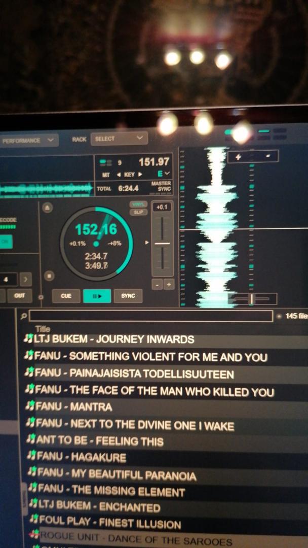

- timecodePitchSliderIgnoreBend
This delays pitch reading display time (results in less fluctations being shown in the displayed BPM). You can switch this off to see if things improve, because sometimes I find the reading gets "stuck", especially at extremes - clone_from_deck
The default behaviour of this also clones the deck pitch slider value, and this creates a range skew if the turntable pitch slider doesn't match the value. Use timecode_reset_pitch to get it to reset to the turntable pitch slider value.
Wrt the photos
Wrt the photos
