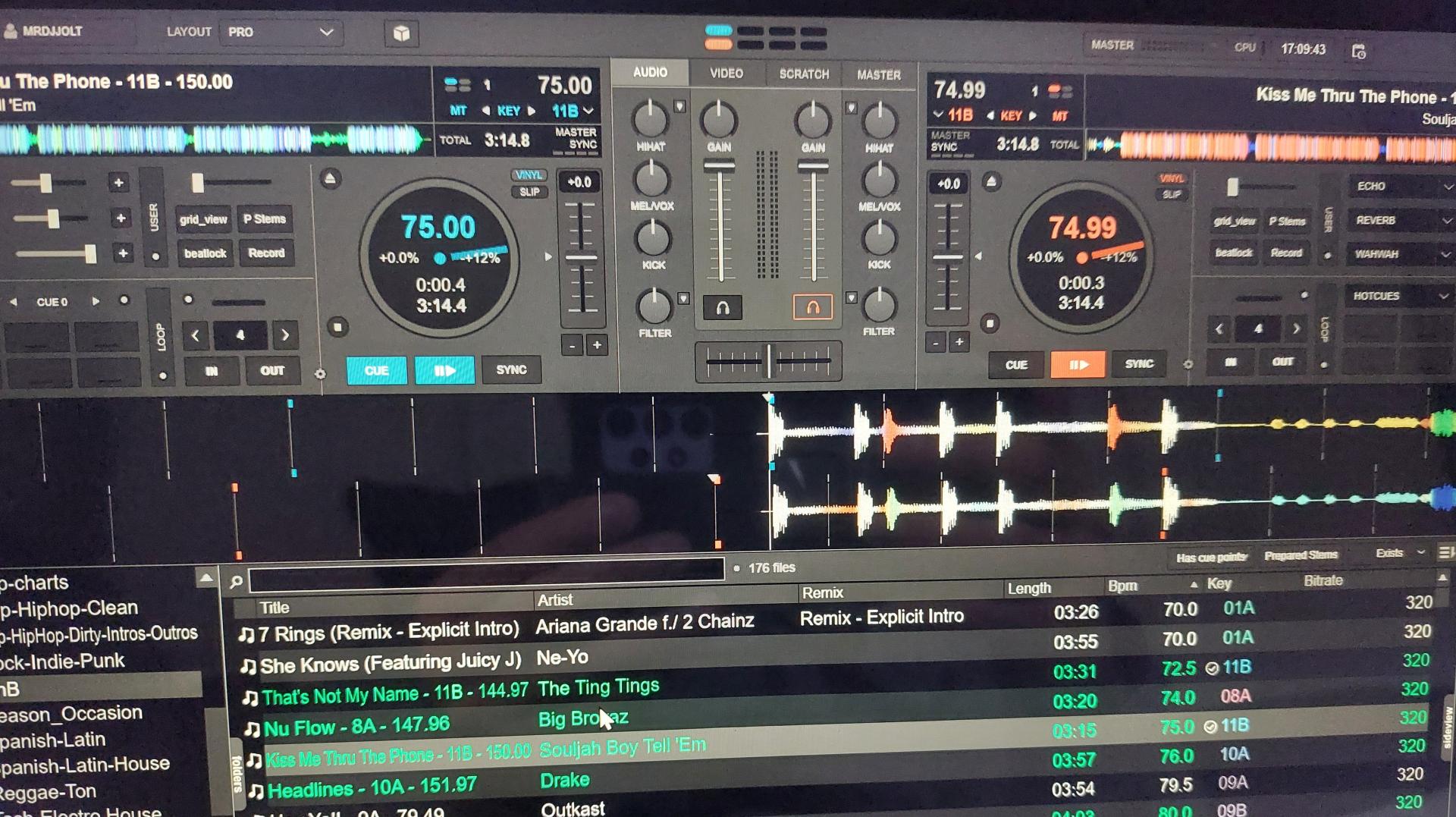

Started using 3000's more now and noticed the beat grids are off on the track files on the usb's compared to the vdj database...after exported from VDJ.
Why is this happening? VDJ ERROR OR CDJ common error? Do I have to adjust every beat grid of every song it does this too for CDJ use? That would be too big of a task.
Pls see pics below.
Pls see pics below.

I will change the beat grid when on the cdj's next time. But as you can see the beat grid on the vdj version is correct already without me changing anything. When exported onto cdj's it's changing the beatgrid by auto....this means i have to check, adjust every song this does it to and will it save the beatgrid i change??. Can't be changing beatgrids of the same song everytime this is annoying atm...

Looking at the pic, I assume the upper waveform is the track analysed by VDJ, with the beat grid correct, and the lower waveform is the one that was exported, and is being read from the flash drive?
Are you seeing this change immediately after the export, or have these files been loaded to a CDJ?
i.e. is VirtualDJ moving the grid on export, or is it being altered by the CDJ?

yes top waveform is virtual dj analysis the correct one. I noticed the change when plugged usb used on cdj back into vdj. I don't know if was altered by cdj or vdj on export. My guess would be cdj tho...

Yes, that's quite a big change.
I could understand a slight shift, because of the translation process between VDJ's beatgrid code and Pioneer's - like translating between any language, it's not necessarily going to be 100% accurate.
