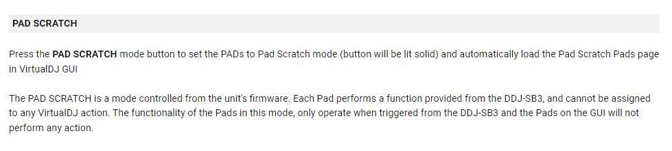

The SB3 is a little different in that regard, because it has the auto-scratch feature, and that's actually "mapped" directly in the firmware of the unit
So those types of pad modes are locked on the SB3
From the VDJ hardware manual for the unit:
